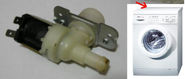

Where did your get that small sprinkler valve?
A good (and usually free) source of smaller solenoid valves is old washing machines and dishwashers, very suitable for BB barrels.
wm valve.JPG (24.38 KiB) Viewed 2793 times

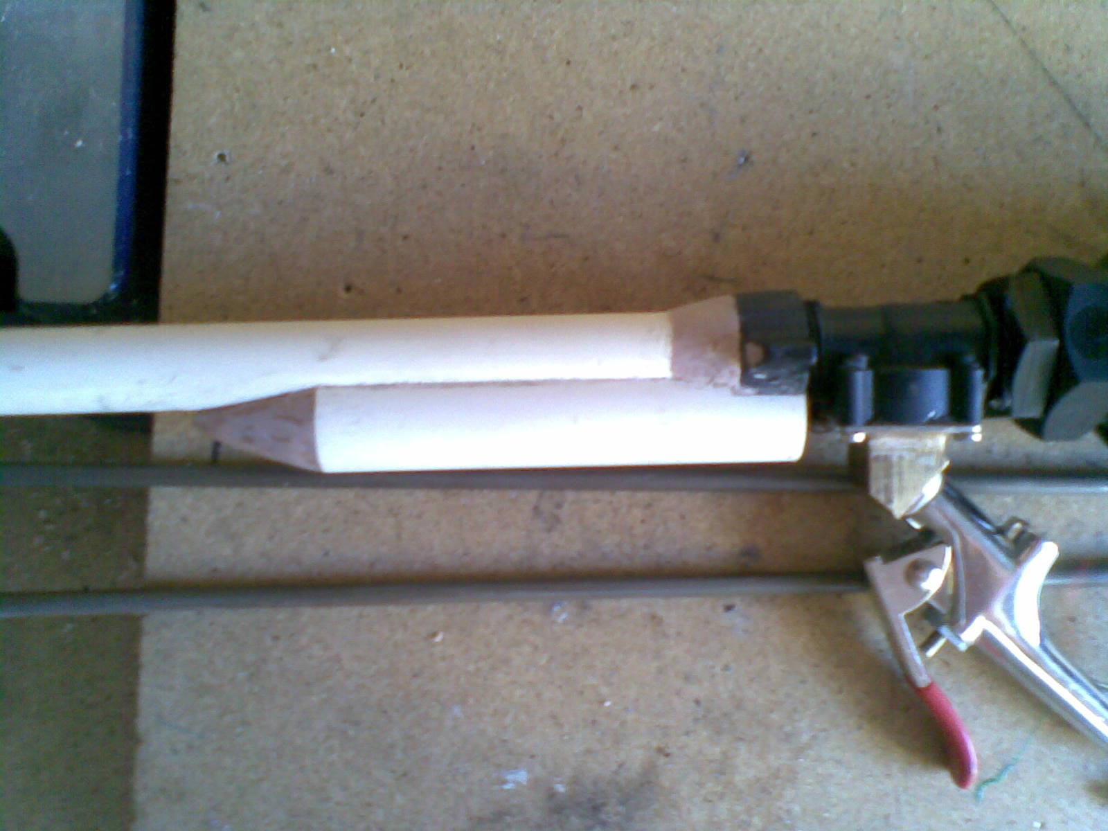

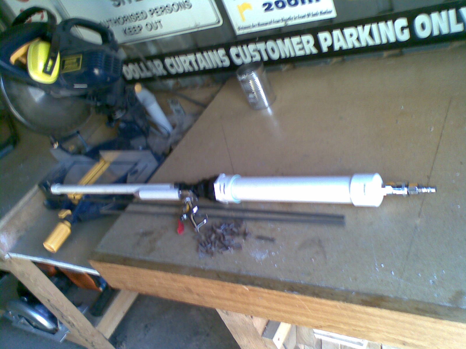

i have put this together
hand grip
hand grip
6mm barrel inside 18mm pvc
dyldo wrote:the semi-auto mechanism isn't working its not moving forward enough to cover the hole and the spring isn't reseting it so iv giving up for a while:(
Sorry to hear that - perhaps there is too much friction in the system?
