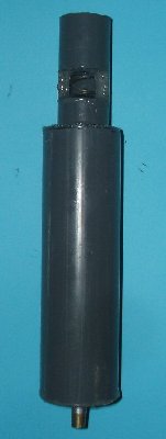

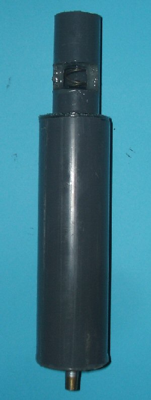

To be honest I've been tempted to let go of my auto quest and make something else, but this is the project for which I have the most motivation, and somehow, I'll find a way
Here's the prototype, pretty isn't it

I still think that it won't give you pulsed source of air, becasue it would cycle way too fast....

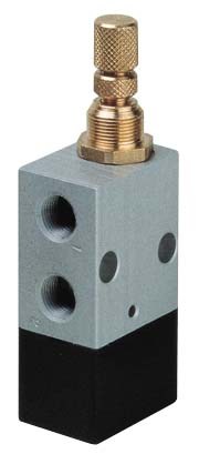

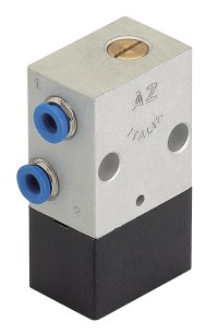

how much pulses per second do you need jsr ? I've found some off the shelf parts that are used to provide pulsed air.... it generates 5 Hz pulses of air (so a pulse every 0.2 second) (sorry but expressing this is very difficult if your not a native speaker of english
It is interesting becasue you can also regulate how many times per second pulses are generated

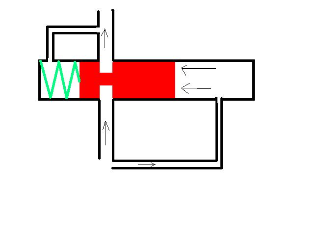

some pics and a diagram that I think might be very useful for you

someone suggested something like this today and I knew that these valves work more less simmilar....JSR I think that all you have to do to make it work is to understand that diagram in my post above....

Ah, bugger it all to hell - cycle too fast, you said? It didn't cycle at all, just popped open and leaked, like the devil's arse'ole at a particularly awkward dinner party.
This one's going straight to the bin, I'm through with reciprocating systems for the time being. It's back to the well-worn drawing board for now.

JSR Maybe it is a good time to buy this valve or at least build yourself something similar.... some of this valves even have a small inbuilt bleed valve to regulate the numeber of pulses / second so you oculd easily reulate the ROF

BTW. tansit234 I just drew my diagram to show how do I understand the way those valves work... and yes you are right that extra pipe in my drawing is not neccesery

That diagram reminds me vaguely of the distributor system in the pneuamtic double diaphragm pumps we have at work.

POLAND_SPUD, I'm strill strugging to understand how this could work - so the air pressure pushes the piston to the left, blocking off the flow, but how does it reset if the air pressure holding it against the spring doesn't drop?
