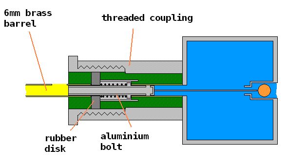

us sniper wrote:Why did you put the magazine in the valve? Why not just do it like the gun JSR just made. That would make it much less complicated to build .
Cos his didn't work? :wink:
Although actually it's to try something different.
ALIHISGREAT wrote:would you be able to reinforce epoxy pycrete style and would it make a big difference to strength?
I have done this in the past by mixing wood shavings or similar filler in with the epoxy, it tends to reduce strength but if you're using it as a filler as in SPG's case you can save on a bit of epoxy.
Well, in the light of recent ideas and developments, perhaps it would have worked if it looked something like this?
