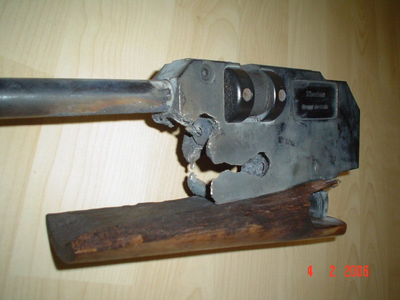

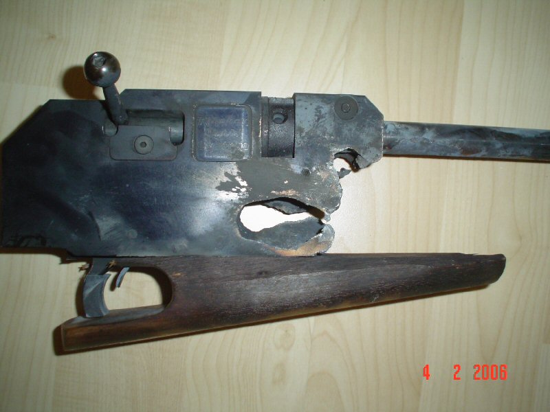

Very good job and nice to see a practical application, however there is one minor niggle:
As an example, this Theoben air rifle was filled with oxygen instead of compressed air. Here's the aftermath:
I would strongly advise against this due to the dangers of detonation.we use an oxygen bottle to fill it because it is easier while we are in the field...

jackssmirkingrevenge wrote:Very good job and nice to see a practical application, however there is one minor niggle:
"I would strongly advise against this due to the dangers of detonation."we use an oxygen bottle to fill it because it is easier while we are in the field...
I was wondering when someone was going to mention that, i thought the same thing but was not sure that the pressure would cause the Oxygen to detonate (one would have to be using some kind of Petroleum lubricant though, is this right?)
At least Dan the man wears a skid lid and goggles i spose.
Of course it needs something to oxidise with and some sort of spark to ignite, so detionation is a lot less likely in a PVC launcher than a metal hammer-valved PCP, but I thought I'd mention it for completeness' sake.Novacastrian wrote:I was wondering when someone was going to mention that, i thought the same thing but was not sure that the pressure would cause the Oxygen to detonate (one would have to be using some kind of Petroleum lubricant though, is this right?)
