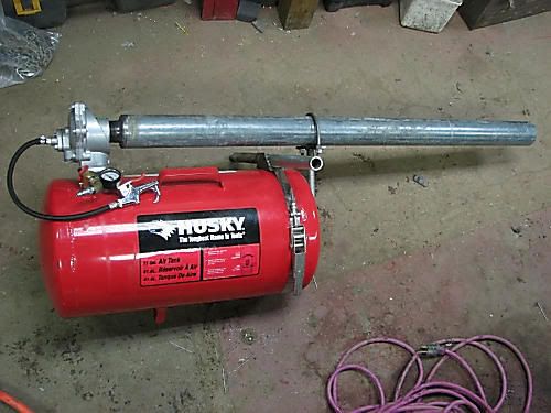

The link BigGrib posted would be an excellent starting point. Lots of good ideas including the breach loader setup. (Add a T and you've got a place for a magazine.)
A smaller sprinkler valve, 1" or even 1/2" would work fine for your use. The sprinkler valve's standard electrical activation would work fine as well.
Any kind of valve that is more efficient than a ball valve or sprinkler valve is probably not only overkill for what you are trying to do but is also too dangerous for firing at a person. WAG for BigGrib's gun, I would say it'll launch a TB at perhaps 500 FPS (~340 MPH). That is more than three times faster than a major league baseball pitcher can throw a baseball. Roughly ten times the kinetic energy of that major league pitcher. Definitely in the energy range that would be far to dangerous to launch at a person.

I suggest a sprinkler valve pneumatic with a very small chamber for quick pressurizing by hand and a very short barrel to keep power down all in an over/under configuration and a pop-safety valve made to open at whatever pressure is safest in your case. Hope all goes well with your project.

Yes, lots of great ideas to start with.
I like BigGrib link also http://www.spudfiles.com/forums/viewtop ... tml#153709
The " T " as a place for a magazine is nice too.
Now I just need to see if adding a CO2 tank supply would work.Kind of the same line as a T-shirt launcher.
