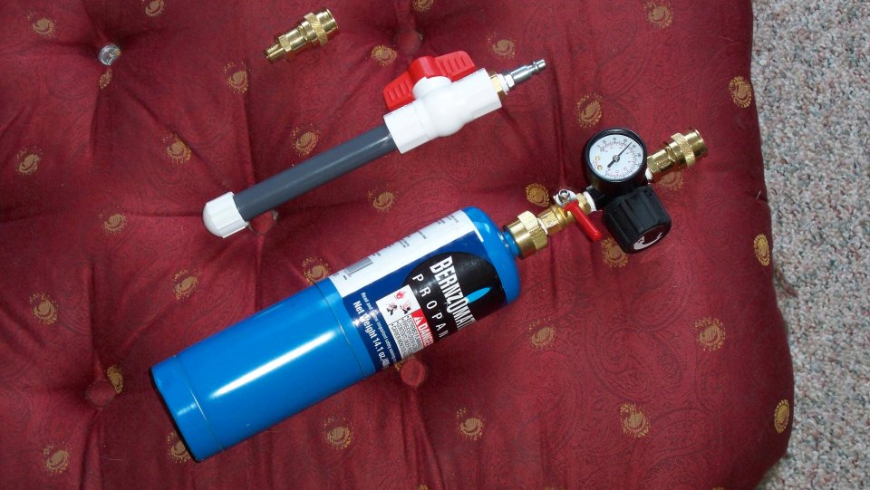

Metered propane need not be difficult...several options are available to you. Here's one I was showing rcman:
Biggrib calls this a 2 stage meter, I think they are all basically 2 stage...this one just isn't permanently attached to your gun. Anyway, snap the "hypo" in the propane system to charge it, disconnect and snap into your quick-connect on your gun, unload the contents, fire away. Keep several on hand and charged up for a quick reload time.

Starman i really like that design and i think that i am going to do that for my hybrid propane meter, is there really any difference compared to a normal fuel meter?
I like this because it makes the gun less bulky and more portable and you can use the same meter for different guns, its really a great idea, thx.

LikimysCrotchus5 wrote:Starman i really like that design and i think that i am going to do that for my hybrid propane meter, is there really any difference compared to a normal fuel meter?
No difference, works the same way. Calculate the meter volume just as you would the 2 ball valve type...only this one uses the same valve to charge and discharge. Just set the regulator for the propane PSI you need...you can literally load one up in 5 seconds...pop it on, open/close the valve, pop it off....it's ready to go. Just keep an eye on the regulator meter that it stays the PSI you need...these can drift some, but not terribly bad.
Meter volume was really easy to measure, just fill with water and measure the water amount after emptying. I used a medical syringe as my measuring tool. This one you see holds 36 cc.
The meter "hypo" shown is only $6-7 each. Big advantage is the propane tank system is portable between guns, so only a one time cost for it. Actually, I like the 16 oz camping tanks of propane for these better than the long 14 oz Bernzomatic tanks.

Well now how about for a hybrid? How much are quick disconnects rated for? Cause i would like to take my hybrid up to par (5x-10x).
I would make this out of black steel, and i would put a schrader rather than a cap, so that i can push the propane through. But i have a question pertaining to SB15's air through meter. Since you put air in the meter, dont you have to add another atmospheric mix of propane through the meter, so that you can equal out the mix?
But its a great idea, i think im gonna take apart my current meter, and buy a quick disconnect and make this meter.

1000 psi or so. These things are designed to feed and hold back some serious air pressure. They are the standard connections that are used on air compressor outputs. You should be in good shape on any real world hybrid.
Re your question about air through the meter... Yes assuming it originally had all the air purged and was thoroughly propane primed, you would need to take into consideration an extra bar of propane in the meter.
