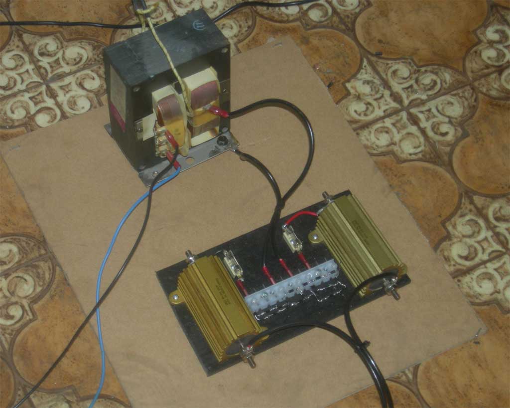

I Have not been able to measured the speed yet, Having some problems with the muzzle-flash.
I don't think this will be the "next generations of spud guns", as Ragnarok says you need some more electrical knowledge then for the average spud-gun and the cost is to high.
The price of the capacitors i have is about 30.000USD if you buy them new from a supplier, in this bank i about 10.000USD worth of caps.
Of course i i didn't paid 30K for them, i got them almost new from disassembled equipment for much less.
I use a variac and a microwave transformer with a full wave rectifier and a current limiting resistor to charge the bank.
Remember the safety, the voltages and currents involved is ABSOLUTELY LETHAL ,if you do something wrong then you are dead.
This thing i really loud and it actually its almost louder then a real rifle.

I'm really glad someone finally made an electrothermal gun. In the future we should have a whole section devoted to electrotherm/electromagnetic guns as technology advances.
I can't really think of anything to say about this other than that. You've done a great job on everything here and I can't really think of any way it could be improved.
Questions:
How much powder do you use for a shot?
Do you have to clean the chamber out every time?
Wouldn't it be better to put the bank in parallel for a higher current pulse?
Any estimate on the pressure you're generating?
Also, (I should probably know this but..) what is the point of the current limiting resistor? Do you risk damaging the bank/transformer if you dump too much through them at once?
Questions:
