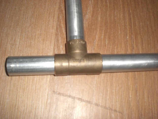

I don't know what kind of pipe it is but he said it could be slodered.
only the barrel is aluminium but that is not doeing to be soldered but with special metal epoxy.
the piston comes in the T piece that now makes a kind of Y so before the valve is only an angle of 45 degree
and I can't get metal pipe with fittings in a big diametre :(
and for making the piston, will olive oil work to prevent the epoxy from sticking in the pipe?

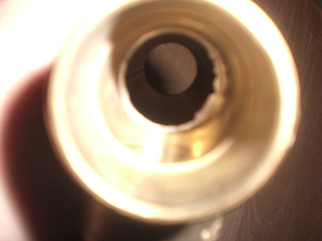

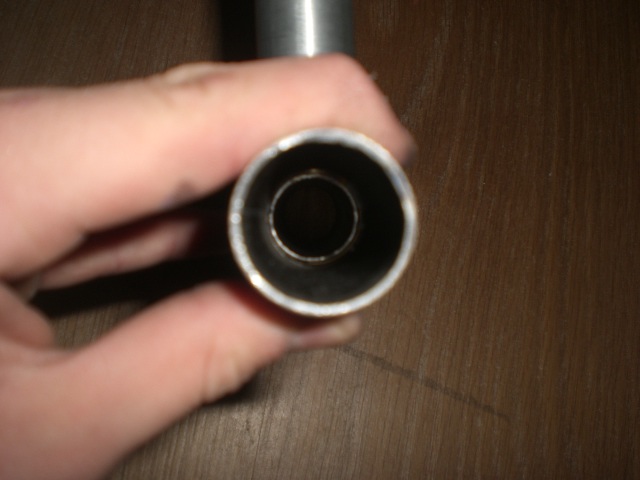

I still have a problem making the piston
here are some pics of were it should come

Your tee and piston should be larger than the porting of the valve.

So where is your piston valve going in this? And is it a barrel sealer or chamber sealer?

Its a barrel sealing piston valve inside that tee, but that tee should be larger in my opinion to create the frontal surface on the piston where the initial force of getting it moving backwards is applied.

psycix wrote:Its a barrel sealing piston valve inside that tee, but that tee should be larger in my opinion to create the frontal surface on the piston where the initial force of getting it moving backwards is applied.
If it is in this location, it sort of has to be a chamber sealer. How is it going to seal the barrel? With it being a chamber sealer it needs o-rings and the force from the chamber will actuate it. If the OP thinks he is making a barrel sealer there, then he needs to do more piston research. This explains it.

I know how a piston works but I think im gonna make a piston like that one from brian the brain (how-to "100% seal no O rings!")
then it doesn't need to be bigger and will seal quite well I think.
and yes the piston comes in the part bluerussetboy circled

I still think you will need a bigger tee.
But ill hear it if youve got it working with a different design.

and do you guys think I need to buy a 28mm to 22mm adapter and then put the barrel into the 22mm. that fits I think. or just use my epoxy
and I did the soldering :P

Using the 28 -> 22 mm adapter would seem the most reliable solution to me.
