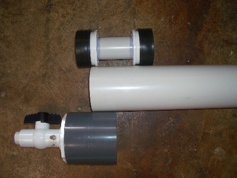

hey man, i spent a long time in the forums trying to get how piston guns worked, sorry if i didnt realize the pilot area had to be that that small lol.
ya ima have to redo that whole back peice i think. i don't know if the unscewable part is really worth it, since the different inside diameter makes me have to make the piston weird, i didn't mention that before.
i think ill extend the back of the chamber a little bit for the piston, and stick a 4"-1" bushing assembly on to save the ball valve, and mount the schrader valve somewhere in there. pity i dont have the threading tools down here >.<
i would have gone with the sprinkler valve in the first place, it looked the easiest, cept i don't think i could get one down here, im in the virgin islands, alot of places don't like to ship to us =( so i went for the piston instead

I think Starman was talking about using the sprinkler valve for the pilot valve, not the actual main valve, which would be a big improvement, if you could get one. Home Depot should carry them.
Lose the "Y". You don't need it. If you have a threader, thread the schrader into the pipe just behind the "new" bushing you need to replace the dwv reducer..
I couldn't find a 4" to 1" bushing, so I went with a 4" - 2" bushing, then a 2" - 1" bushing, piloting with a 1" sprinkler valve modded.
I tried the "threaded" approach to accessing the piston for maintainence. I couldn't get it to seal like I wanted. I instead went to a slip bushing. I just glued a section of pipe into the back of the tee which housed my piston. I then bolted it on with four small bolts with sealant. All I have to do is take the bolts out, and slip off the bushing/pilot valve for access.

Surely they have a 7/16 drill bit and a 1/4" NTP tap available somewhere there. Not at the corner drugstore but it isn't plutonium either.elitesniper wrote:He said he wished he had a threader.

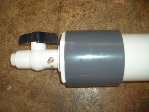

Second image.... "IMG_0512 Medium Web view.jpgelitesniper wrote:He said he wished he had a threader.
Description: back end. schrader valve is screwed directly into the pvc (used a threading tool) with teflon tape

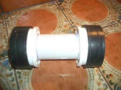

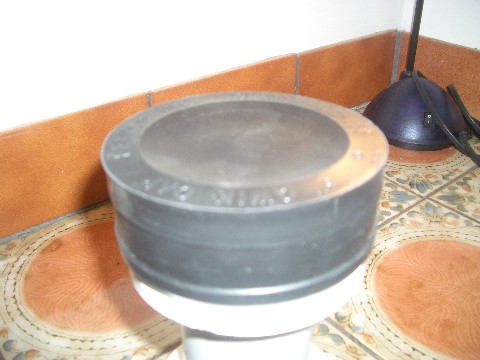

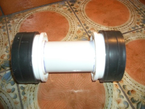

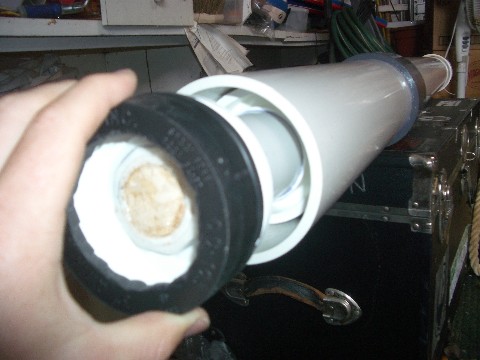

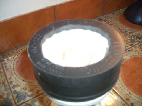

Ok,
remade the whole pilot end and plugged the piston, and it still wont seal >.<
pictures attached.
ive tried it with a nice bicycle pump and a 125psi compressor, no dice.
pictures attached.

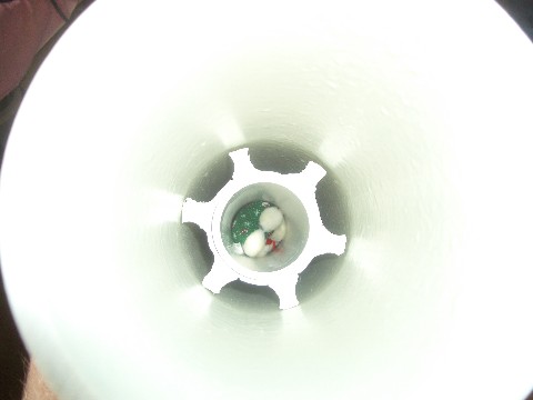

- Inside Chamber and Barrel, test ammo included, if it would ever fire. sry flash kindve made it too blinding to see
