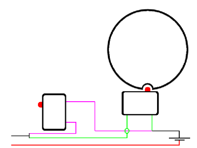

SPG wrote:A speed control would provide variable rate of fire, and a simple bit of circuitry on the back of the motot could make sure that the barrel always stopped in the AIR CLOSED position.
What kind of circuitry are you talking about exactly? And would I be able to buy a speed control and an electric motor at, say, Radio Shack?

Err, no I doubt it'll work and also it's got an insanely high rpm, which would give you an insanely high rate of fire. It's listed as having a no load speed of 24,000 rpm, even if we divided that by four for the load, does anyone have 6000 BBs they can fire per minute?
If you can I'd go for an RC car motor, in fact if you can find an old RC car in a dumpster or somewhere get the whole thing, as you'll get a decent hi-torque motor, a speed controller and some gears to play with. Just think you could make an RC-BB-MG.

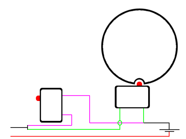

As for the electro-mechanical circuitry, here's a rough diagram, which should work, it's based on how wiper motors work in cars. You can see the two micro-switches are wired in parallel to the motor and battery, the rotating disc is attached to your motor.
CLICK IMAGE FOR ANIMATION:
Squeeze and hold the trigger and the circuit is made and the motor rotates continuously; release the trigger and the motor continues to rotate (because the second microswitch is now also making a circuit) until the notch allows the microswitch to open, and the circuit is now broken.

Wow, that looks really great. But do you know of a way to make the bolt stop at the closed position for a certain amount of time? Ideally, I would want the bolt to spin as fast as it can until it seals. Then it would stop for a specified duration, which can somehow be controlled. Finally, it would spin as fast as it can to the open position. It would be fine if it was only semi-auto.

you know a rotating seal like that wont seal with orings, you'll need a vinyl tube seal

I don't think it needs a seal at all. What's I'd suggest is that any "trigger" not only works to control the electric motor but also acts to open the gas valve.
Sure a little bit of gas is going to leak and be wasted WHILE you're in the firing cycle but the main time you want a tight seal is when you're not firing.
As for making the motor stop at a specific position with each cycle I'm sure it can be done, but I can't personally work out how to do it, I thinkit'd need some form or micro-processor control and that's well beyond me, I'm more an electro-mechanical kind of guy.
