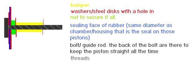

SpudFarm
Posts: 2571
not much to say the diagram says it all.
ask if you don't understand (Crowley did not understand)
read and look closely
piston diagram2.jpg (20.87 KiB) Viewed 2575 times
"Made in France"
- A spud gun insurance.

Crowley did confuse me,lol. But I still don't get it, why none of them I make work. I just wish I could know what I was doing wrong.
BTW
Sorry, but I don't get the diagram.........

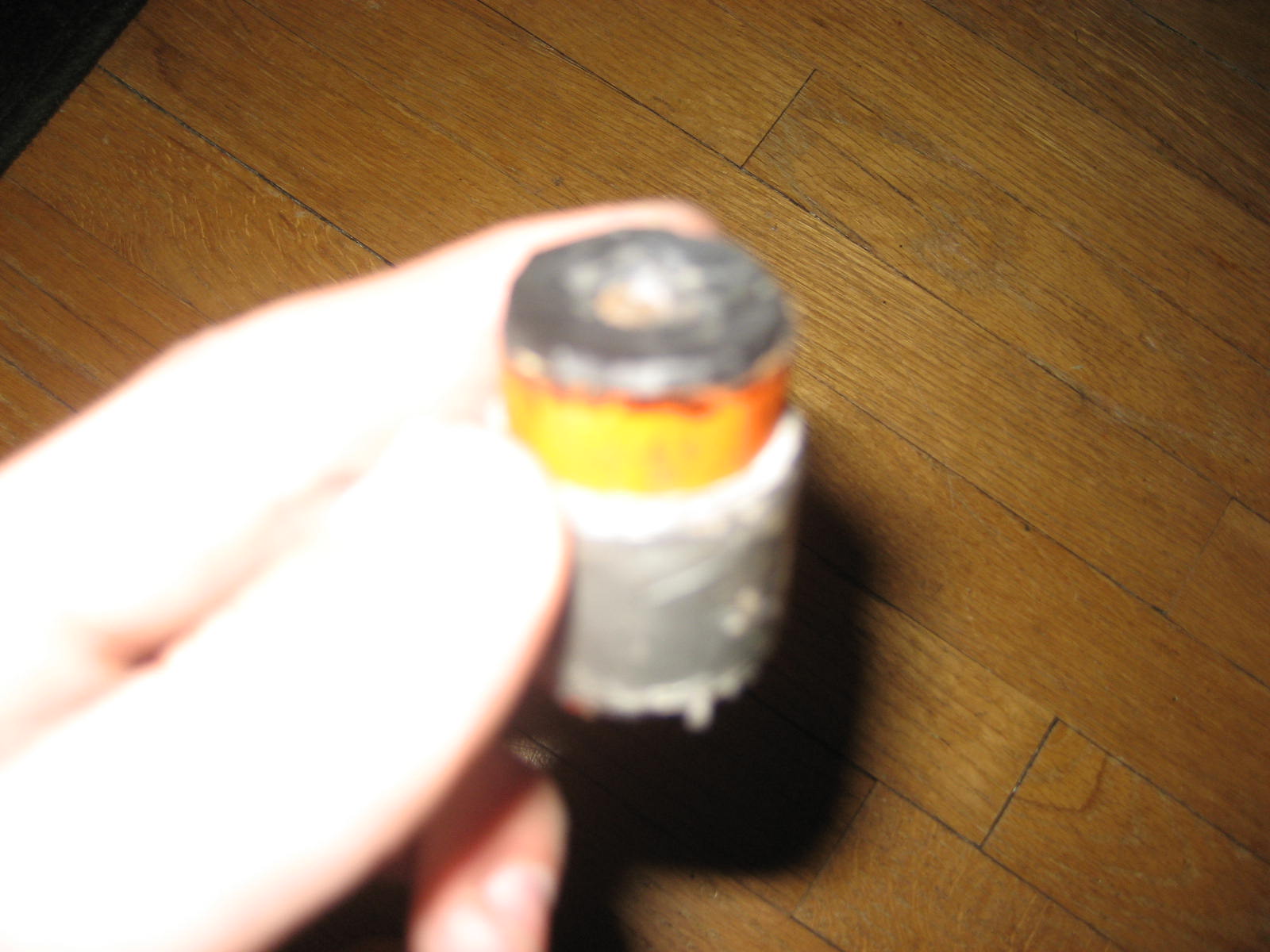

Here she blows.... sorry for the bad picture quality, I'll turn off flash next time.
Piston..
Piston..
Looks like it's got some rough edges, how about the cylinder it slides in.

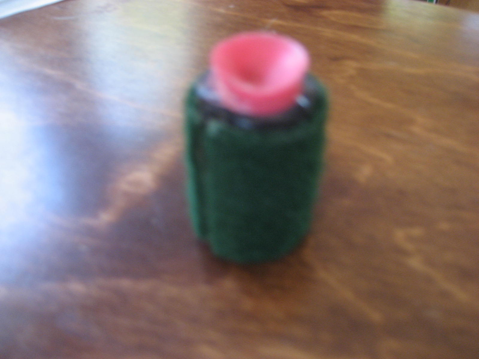

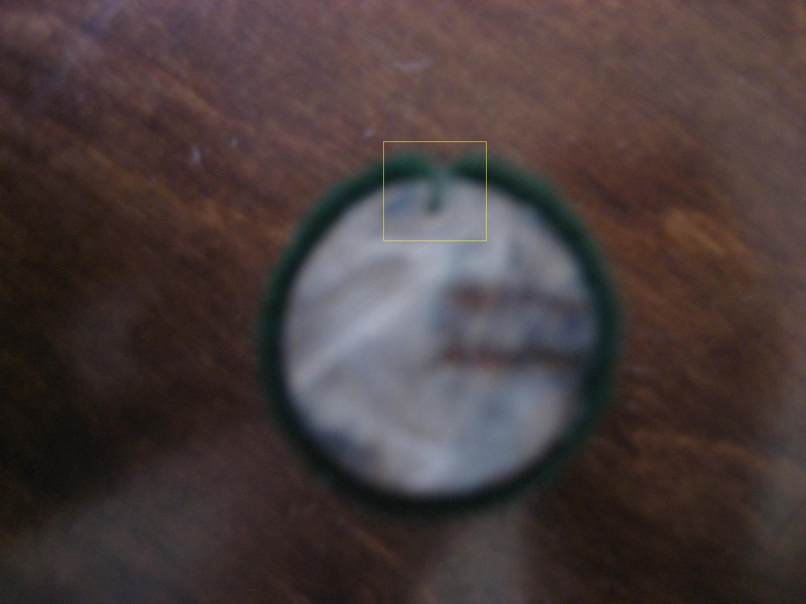

I'm sure spudfarm did not mean to offend you. And here are some pics of my NEW piston. It is made of wood, felt, a rubber washer and a rubber piece I found. I also pust some silicone around it to help the seal.
Whole piston. You can see the equilzation cut down the side.
Here is a look at the bottom angle. You can see at the top, the bottom of the equilization cut.
Blitz
Posts: 627
Location: Illinois
Cool, it kinda resembles a pill bottle in that last photo. What kind of wood did you use for the piston material?

I used dowel rod, its about 3/4 inch. :P
