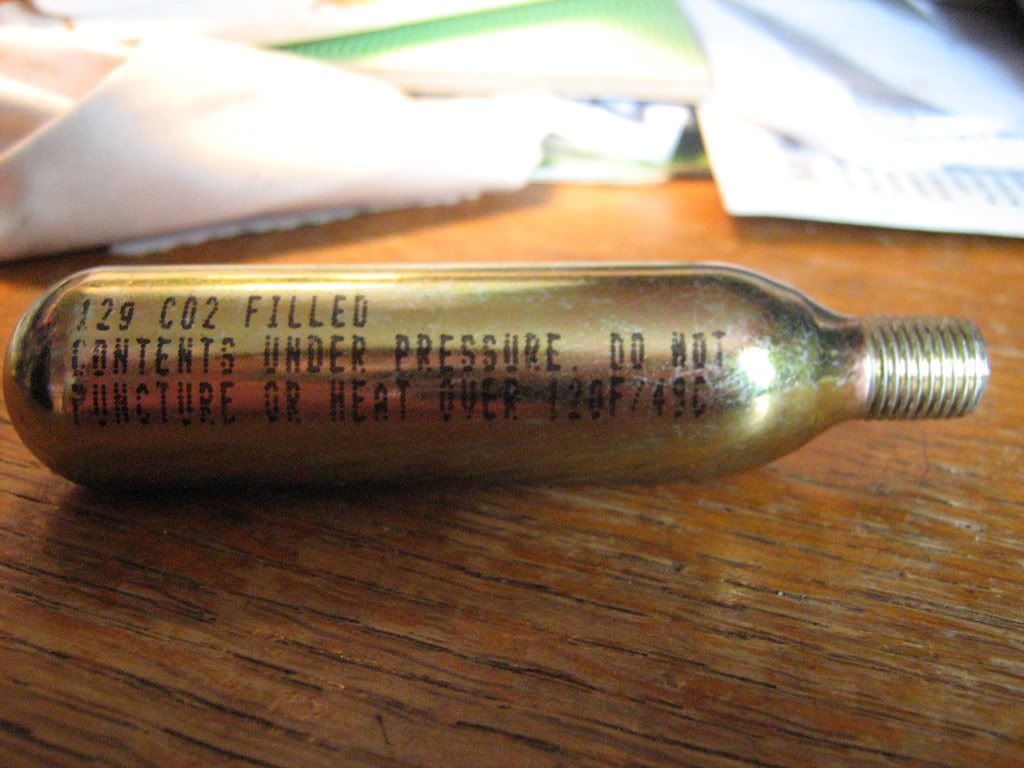

they do have threaded 12 grams, but they are to use in those bicycle tire inflators and also some air powered pellet guns use them. but i have never seen them used in paintball.
12 grams co2 bottle adapter
I know they were made for other things, but I've never seen them for paintball either. It just seemed to me that he didn't want to listen to experience. I figured I would try and help.
Well, they certainly exist:hubb017 wrote:I'm with Grumpy. Maybe you could provide a link to these threaded 12g cartridges you speak of?
They may not be regularly used in paintball, but I don't see why that means they can't be.

Hmm, I've seen the inverse. On any website where I've seen threaded 12g bulbs, they usually cheaper than the unthreaded ones, by anywhere from £0.01 to £0.05 per piece depending on quantity. It's counter intuitive, but that's what I've seen.goathunter wrote:Do not go with the threaded 12 grams. They are much harder to find and more expensive. Just buy a quick changer for regular 12 grams.
Also, it's common that on sites that sell them wholesale (the logical way to buy them in bulk), that both varieties are sold.
Buy one on it's own in the UK, and it's about 50p. Buy 500 or 1000 at a time, and they drop to around half that.
If you're planning on using a lot (although to get through a thousand 12 g bulbs might take a while), then there's no other sensible way to do it.
Of course, all my findings relate to the UK, so I can't confirm it's the same in the US, but I'm a little surprised to say the least.
i do not know the price differences, i do know that the threaded ones will not fit in the 12 gram quick change adapter used in paintball. you need a threaded adapter that the 12 gram will screw into, what demon does not understand, is that with any of the adapters the co2 cartridge is opened when you screw it in.

They are much more expensive in the US. The threaded kind run about $2-3 a piece whereas the regular ones are$.50. I think the price comes from the availability. Pretty much the only places I've seen threaded 12 grams sold is at marine parts stores or outdoor shops. Both of those enjoy jacking up pricesOf course, all my findings relate to the UK, so I can't confirm it's the same in the US, but I'm a little surprised to say the least.
