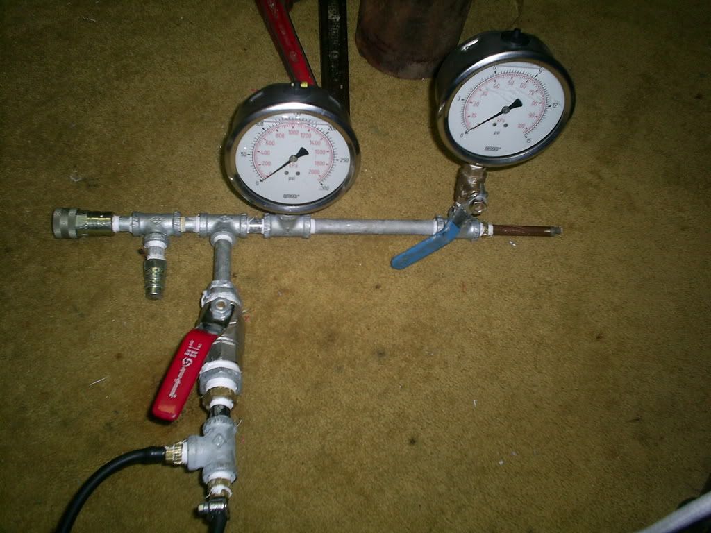

Haven't you read my "Hybrid1" thread?
It isn't any secret, and it was developed long ago. I just call it mine because I was the first (that I know of) to actually get around to implementing it.
It will eventually be universal, but for now it's only capable of 1-20x air/propane, and 2-25x oxy/propane.
Ports: Outlet, air, oxygen, propane, 0-300psig Grade 1A gauge, 0-15psig Grade 1A gauge.
In short, it measures chamber pressure developed by fueling, accurately enough that you can meter 1x mixes with it (0.6psi propane).
I do have doubts that many scales that could take the weight of a large hybrid full of water would have any precision beyond perhaps 0.2 kg jumps (which would be +/- 0.1 kg)D_Hall wrote:If you have a decent scale, weight it empty and full (of water).
You might get lucky and find a 0.1 kg graduated one, but that's still quite a large amount of room for error.
There is however, no need to fill cup by cup. With a large funnel and a 1 litre jug, a hybrid of around 600 ci would only need 9 fills from a litre jug, and after that, you could switch to a smaller, more precise measures to do the remaining 800 cc or so.
Of course, I do seriously recommend DYI's metering system, as you have absolutely no requirement to measure chamber volumes.
The metering works by injecting a pressure, rather than a volume of propane - SpudBlaster did a very good write up of the maths involved.
You then top up to the full pre-ignition pressure with air.
DYI could take that meter, attach it to any hybrid in the world - from the monster D_Hall is designing, all the way down to Nova's Brass Bruiser - and without a single measurement (although perhaps a few button presses on a calculator), use it to accurately fill to up to 20x mixes.

I don't think you quite understand yet; there is no metering pipe. You don't even need to inject the fuel through the meter. Take D_Hall's Pipe Dream for example: He could have the exact same fuel and oxidiser delivery systems (probably 2" hose or somethingGranted it could take ages to fill one of the larger ones.
Though it could easily be adapted to have a larger metering pipe to fix that.
I'm guessing that the reason nobody has built one of these before is that the gauges cost about $30 each. However, with a conventional system, the meter needs to be customised to the individual launcher, meaning a new meter for every hybrid.

Ooooooooooooooohh I get it now! That is absolutely genius! I may just have to do that, though the gauges are rather expensive.
In a different way, I suppose you could think of the chamber as it's own metering pipe, and DYI's meter as just an advancement of the gauges people have on their external meters
...although it seems increasingly less common these days... but a good example is here on Latke's miniL1: http://www.burntlatke.com/jpg600/mini-side.jpg
Rather than filling a meter volume to a set pressure, you fill the chamber itself to a set pressure. It's simple, but ingenious - no conventional captive volume metering here.
I understand that but will the gauge I posted work?In a different way, I suppose you could think of the chamber as it's own metering pipe, and DYI's meter as just an advancement of the gauges people have on their external meters
The plumbing site has no mention of the gauge's accuracy, or even accuracy grade. If it's a "D" grade, it won't be accurate enough. I rarely ever make a purchase without all the information on a product, and this just seems like a bad idea.
On McMaster, all the relevant information is given, the selection is enormous, and the prices aren't very bad in most cases. I used 4053K16 from McMaster. The 1.5" and 2" face versions are GradeA (+/- 1% mid scale accuracy), and the 4" face version (the one I go) is Grade 1A (+/- 1% full scale accuracy). They're the best deal that I managed to find.
