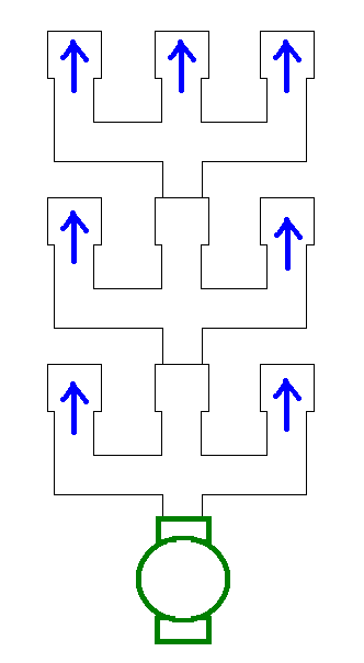

hmm...I have an excellent plan. Let me draw it up for you.
should only take a sec :wink:

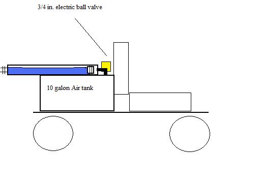

I did a test with a water rocket about 2 months ago. It was about 6 feet of 2 in. PVC normal temperature at 90 psi. The valve a used was a simple 1/2 in. ball valve but my friend would hit it with a hammer. He wieghs about 110 lbs and when we strapped this to a dolly cart, he went a good 6 ft., I know it doesn't sound like much but it was hell-cool. I think I already posted some plans to one here. I figured out that a much more efficent system would be to have a piece of 3 ft. pvc pipe with a piston inside and a burst disk at the end. when the main valve was releasedon the air tank, the air push the piston forward super compressing the water and popping the burst disk, shooting out a jet of water.
Heres my thread, I believe Ragnorak suggested the piston idea.
Posted are my new plans too (rough sketch)

Here, before examining my plan, look at this gun to see what I mean by them:
Trident Antenna Launcher
The blue arrows indicate the air flow to the bottles<br />The green is the modified sprinkler valve

sthorne,
thats what i was originally thinking. And don't you mean air flow from the bottles?
EDIT:Oh, sorry.

igpay wrote:sthorne,
yeah, to and from. Same difference, you know what I mean :wink:
