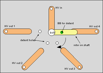

Brplatz: Yes, the resistive ignitor will work. You need a heck of a lot of current but if you have several RC batteries that should be enough.
Back to the original high voltage siwitch idea. Just get a multiposition switch from radioshack and give it a try. If you keep all the spark gaps in the guns small then there is a good chance you'll be able to get it to work like you want. Since a combustion gun really doesn't care how big the spark gap is you can just use very small gaps (less than 1/16") which should be less than the gaps in the selector switch.
Building a switch wouldn't be all that hard. Start with a piece of copper clad board (from Radioshack). Draw a pattern on the board with a Sharpie marker, etch in 3% hydrogen peroxide + Chlorox bleach. Make the rotor from a choped up coffee can on a bolt axle. If you want to get fancy, add a couple holes to the board and whole in the rotor that are a bit smaller than a BB. Use the BB as the detent mechanism.

But you don't need a 50KV selector switch. You need a selector switch rated at higher voltage than your spark gap(s). An 1/8" gap would only need a switch rated to 125~400V (that's the voltage rating when the switch is open).

i think i will get a selector switch from radio shack an see if it will work.
If not i will have to make my own but it shouldn't be to bad. i like that homemade switch that jimmy suggested
