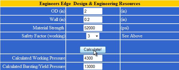

SpudFarm
Posts: 2571
i can't have done that right..
whooha!
whooha!
2 fittings.jpg (30.12 KiB) Viewed 3536 times
"Made in France"
- A spud gun insurance.
Gippeto
Venezuela
Posts: 2506
Been thanked: 17 times
Your wall thickness seems too much. I prefer to use the thinnest section when calculating burst/yield pressures.
Usually the wall thickness at the deepest part of the thread.
SpudFarm
Posts: 2571
but the threads helps also. (i may did it wrong since i usally uses mm)

Gippeto
Venezuela
Posts: 2506
I don't know about the fittings and pipe that you have in Norway, but the stuff I use still leaves more than one thread to atmosphere when tightened.
That makes it the thinnest section, and the thickness to use for calculations.
You are ALWAYS better to err on the safe side.
.2" = 5.08mm
