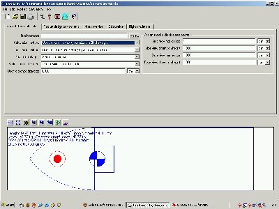

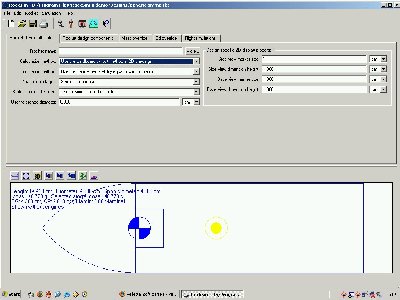

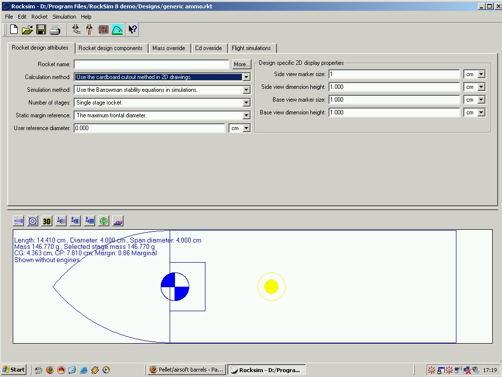

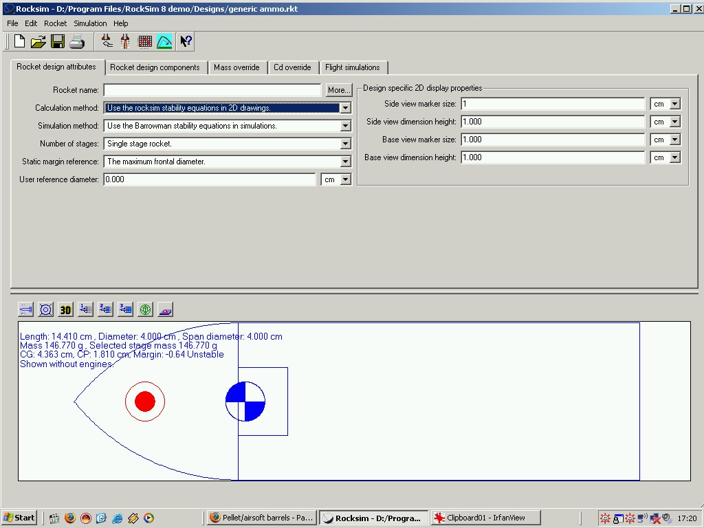

yeah JSR I knew about that before - it seems logical... and I would like that to be true...
however when I use rocksim I get different results when I either select 'rocksim' or 'barrowmans' stability method' for calculating stability... using 'cardboard cutout method' gives results that are in accordance with what you said
I'd add 2 pics ( in both pics the blue dot is the centre of gravity, the other one is the centre of pressure)
Eventhough what you said is ok to me I still don't know why rocksim gives results which are...... hmm contradictory? (well to some extent they are) it seems I have to wait for D_Hall to answer that question

1) The Barrowman equations are a set of equations that were developed by a guy named Barrowman (imagine that!) for predicting the stability of slender, finned objects (ie, rockets) back in the days before CFD was available. Your projectiles are neither slender nor finned. As such, any results that the Barrowman equations yield should be taken with a grain of salt.POLAND_SPUD wrote:however when I use rocksim I get different results when I either select 'rocksim' or 'barrowmans' stability method' for calculating stability... using 'cardboard cutout method' gives results that are in accordance with what you said
2) The "cardboard cutout" method is really nothing more than than the calculation of mean projected surface area locations. It's a sloppy method but it's computationally trivial so it's been popular in the hobby world since the days of slide rules. Why anybody would use it today is beyond me (exception for people who are trying to get rough numbers on the back of an napkin while talking rocket stuff at the local pub).
3) The RockSim method... Not sure what that would be. They'd need to publish but I gather they don't feel like doing that. Most likely, it's probably a derrivative of Barrowman.
Suggestion? Get your hands on DATCOM. It's old. It's hard to use. But it's free and gives pretty damned good results. Note that it's an old code that the miltary developed in the days before CFD. It too relies heavily on Barrowman's work, but there was also a lot of artillery shell-based stuff in there as well.

BTW - rosksim works fine (it gives expeted results) for designs resembleing a diablo aigun pellet or even the Appolo crew capsule but it has serious problems with designs that I posted
