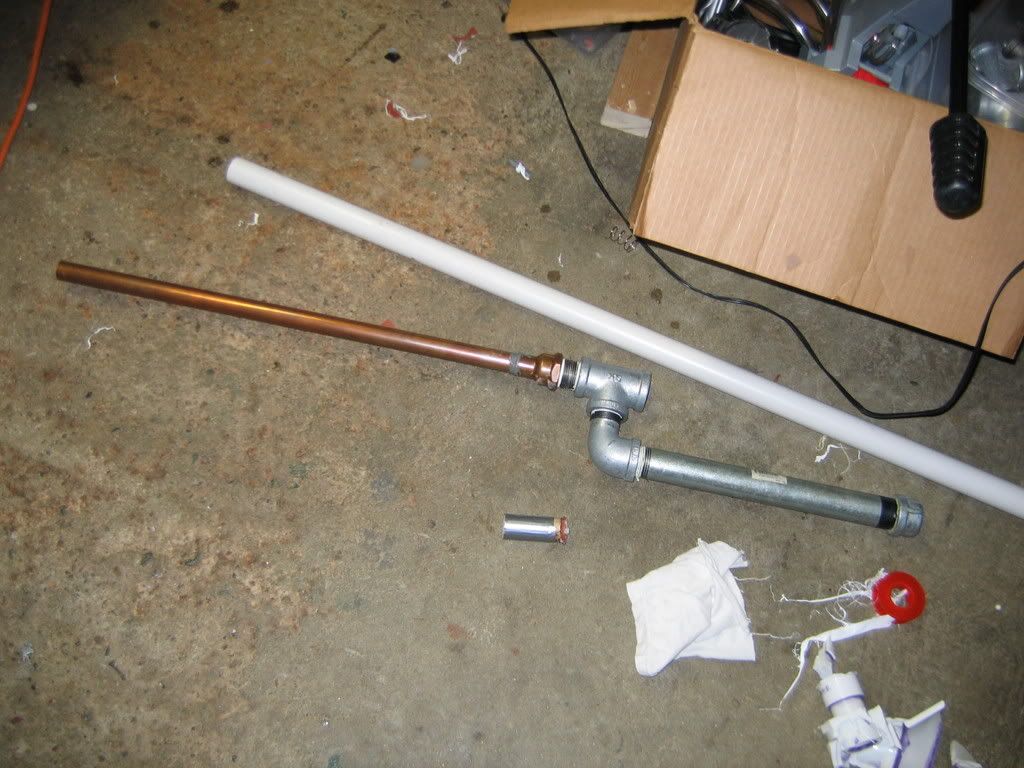

The whole cannon
<a href="http://s184.photobucket.com/albums/x58/ ... G_1864.jpg" target="_blank"><img src="http://i184.photobucket.com/albums/x58/ ... G_1864.jpg" border="0" alt="Photobucket"></a>

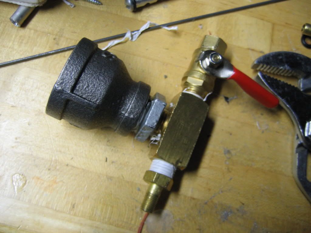

The Pilot/fill Assembly
<a href="http://s184.photobucket.com/albums/x58/ ... G_1862.jpg" target="_blank"><img src="http://i184.photobucket.com/albums/x58/ ... G_1862.jpg" border="0" alt="Photobucket"></a>

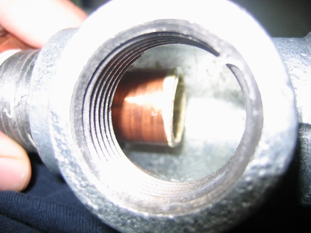

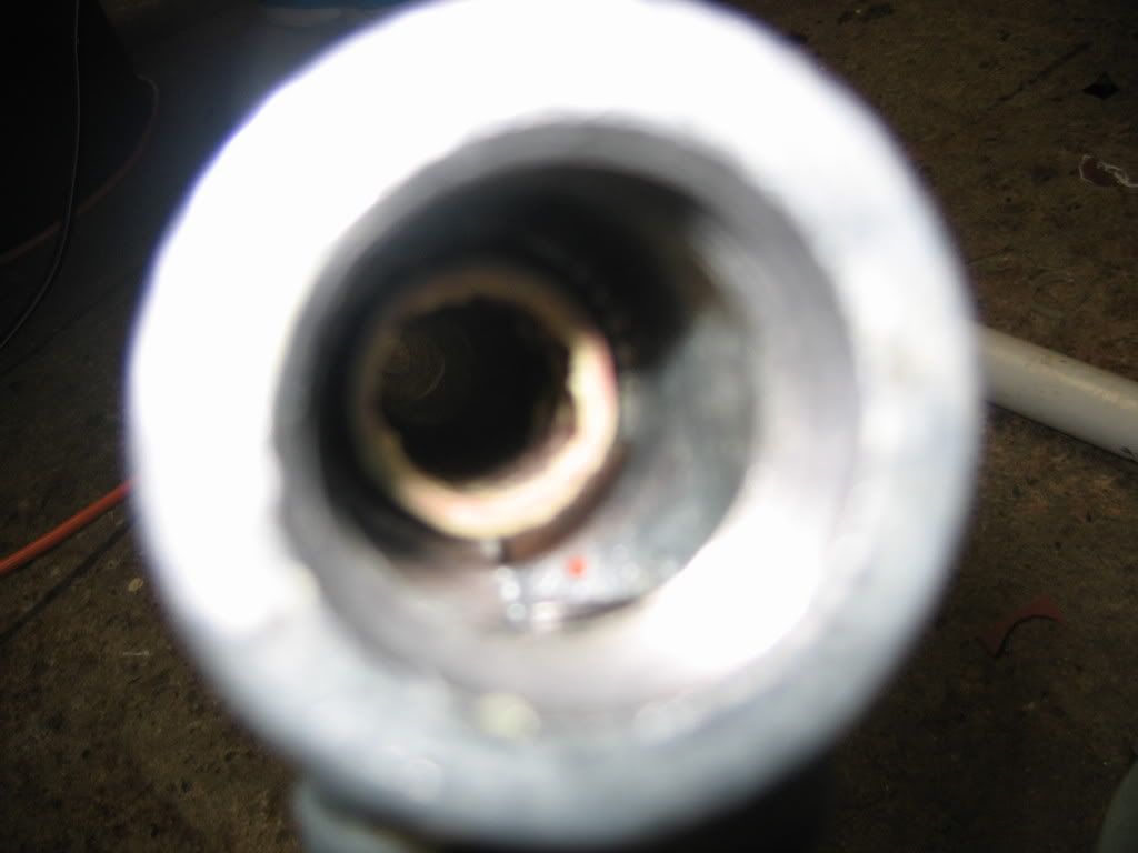

Some shots of the barrel goning into the tee:
<a href="http://s184.photobucket.com/albums/x58/ ... G_1865.jpg" target="_blank"><img src="http://i184.photobucket.com/albums/x58/ ... G_1865.jpg" border="0" alt="Photobucket"></a>
<a href="http://s184.photobucket.com/albums/x58/ ... G_1866.jpg" target="_blank"><img src="http://i184.photobucket.com/albums/x58/ ... G_1866.jpg" border="0" alt="Photobucket"></a>
<a href="http://s184.photobucket.com/albums/x58/ ... G_1868.jpg" target="_blank"><img src="http://i184.photobucket.com/albums/x58/ ... G_1868.jpg" border="0" alt="Photobucket"></a>

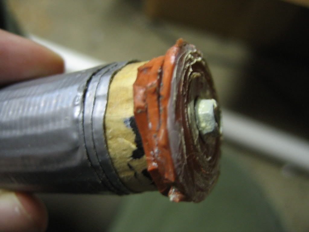

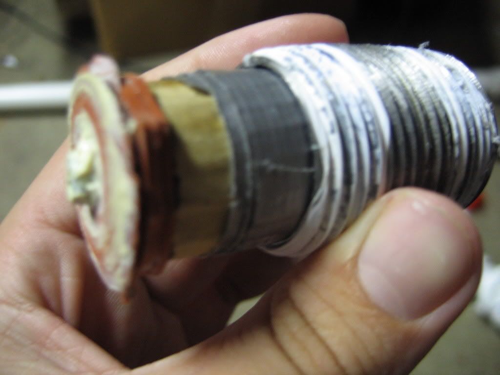

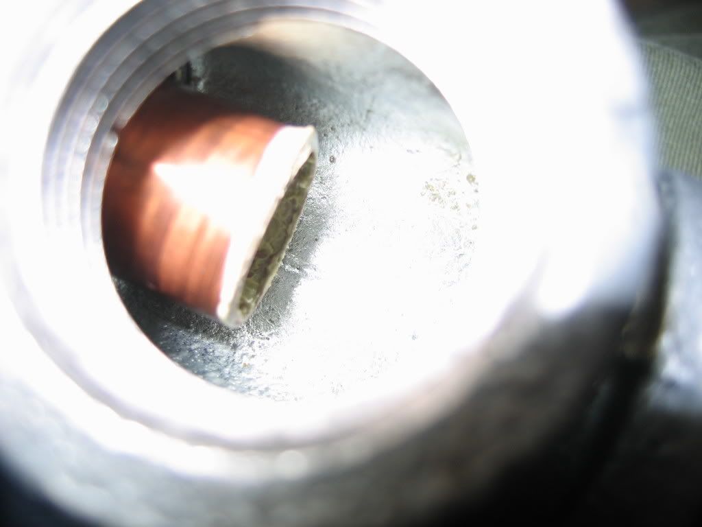

The piston, That white junk is lithium grease
<a href="http://s184.photobucket.com/albums/x58/ ... G_1871.jpg" target="_blank"><img src="http://i184.photobucket.com/albums/x58/ ... G_1871.jpg" border="0" alt="Photobucket"></a>
<a href="http://s184.photobucket.com/albums/x58/ ... G_1872.jpg" target="_blank"><img src="http://i184.photobucket.com/albums/x58/ ... G_1872.jpg" border="0" alt="Photobucket"></a>

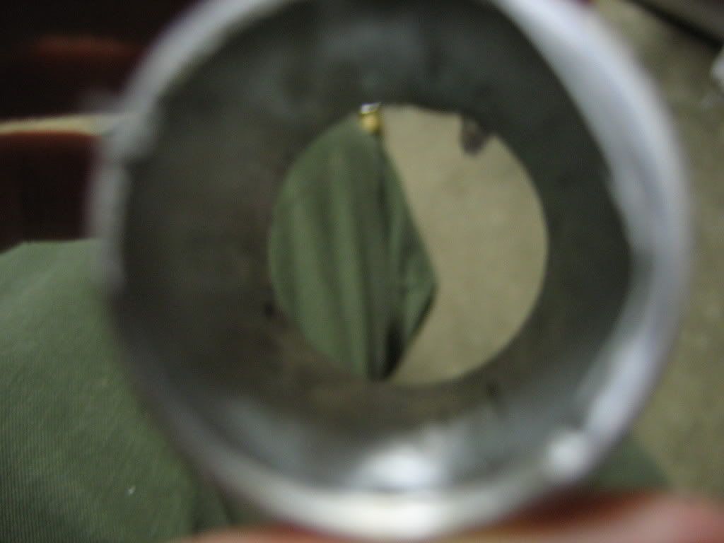

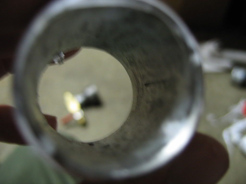

The Nipple which I dremeled out to be smooth:
<a href="http://s184.photobucket.com/albums/x58/ ... G_1873.jpg" target="_blank"><img src="http://i184.photobucket.com/albums/x58/ ... G_1873.jpg" border="0" alt="Photobucket"></a>
<a href="http://s184.photobucket.com/albums/x58/ ... G_1874.jpg" target="_blank"><img src="http://i184.photobucket.com/albums/x58/ ... G_1874.jpg" border="0" alt="Photobucket"></a>
Almost no space between the side of the piston and the side of the nipple
<a href="http://s184.photobucket.com/albums/x58/ ... G_1875.jpg" target="_blank"><img src="http://i184.photobucket.com/albums/x58/ ... G_1875.jpg" border="0" alt="Photobucket"></a>
All of it together:
<a href="http://s184.photobucket.com/albums/x58/ ... G_1876.jpg" target="_blank"><img src="http://i184.photobucket.com/albums/x58/ ... G_1876.jpg" border="0" alt="Photobucket"></a>
The gap looks too big in some areas and too tight in others. Either tape your piston evenly or get rid of the tape. IMO, the piston is getting jammed in some areas and the air just goes through the gaps.
