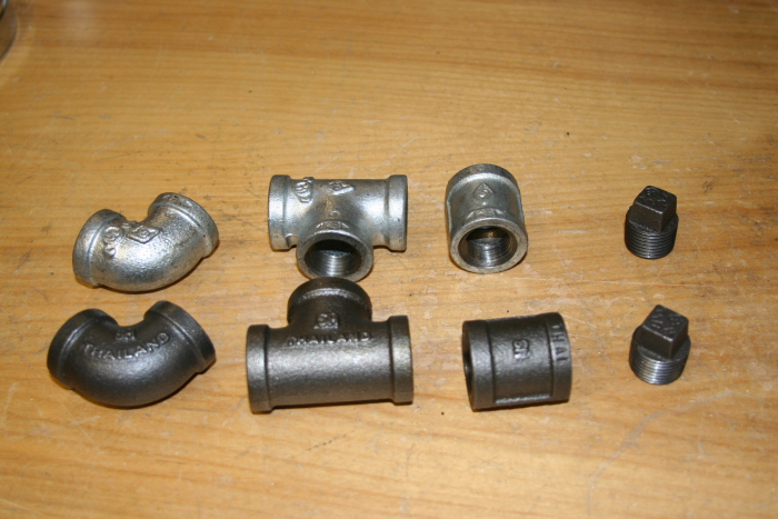

Anyway, I said I was going to upload some pictures, so without further ado...
Edit: Had to resize pictures. (slaps forehead). They should be "up" now.

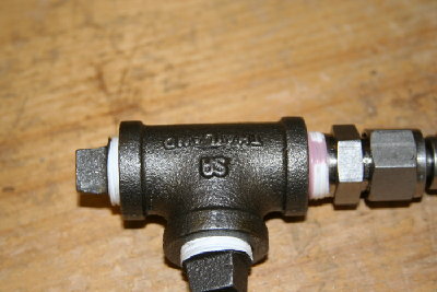

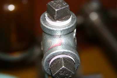

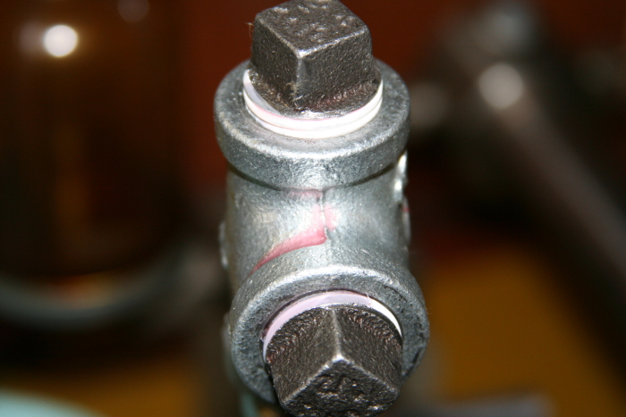

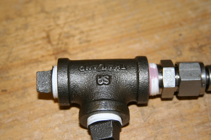

Yes the cracks are visible.
On the first tee, the crack is between the two "lines of writing".
On the second tee you can see it leaking oil from the mold separation line. This is where it cracked.
The damage is limited because of the chosen testing method.
But rest assured, those fittings failed.

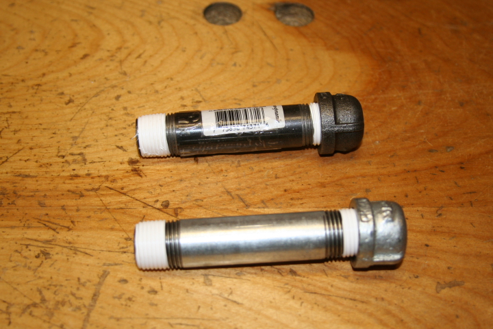

I have finished testing 1/2" pipe. Galvanized and black with end caps.
I used the same procedure and pressures outlined for the fittings.
Both types of pipe, and their respective end caps withstood 70000kpa.
As a side note, I would like to add that ALL fittings and pipe that were tested, have been discarded to avoid any potential mishaps.
