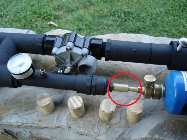

I know this is an old topic but I was curious as to the fittings you used to hook up the propane torch valve to the chamber of the cannon, I am making this same setup but found myself stuck when I found out that the threads coming out of the valve are not 1/8" NPT, so how did you do it? Solder anything? Any help is appreciated. I circled the area I am confused about...

The fitting had to be silver soldered, just the stem of a torch soldered to a half section of 1/4 inch pipe/threads i know they make fittings for the propane bottles but I've never tracked one down sorry
