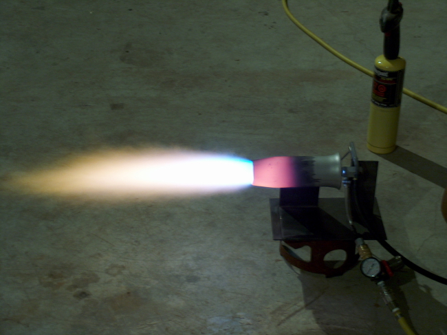

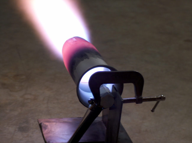

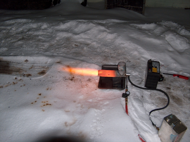

I thought I mentioned that?
The burn tube is made from 2 1/2" exhaust pipe. The nozzle is a modified 175000btu unit from a Mr. Heater kerosene heater. (I think it's made by Delavan) The nozzle holder is stock.
The shape and length of the burn tube, especially the taper section, will determine how well the burner works.
Go ahead and try your coffee mugs, they might work fine.
