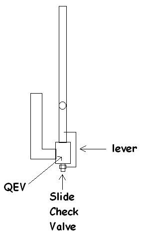

This was just a test. I will be configuring it so that a golfball can be dropped down the barrel (like a mortar) and it will strike a lever that moves the slide check and fires the gun.
It slides rather easily too and with leverage the ball should have no problem closing the check.

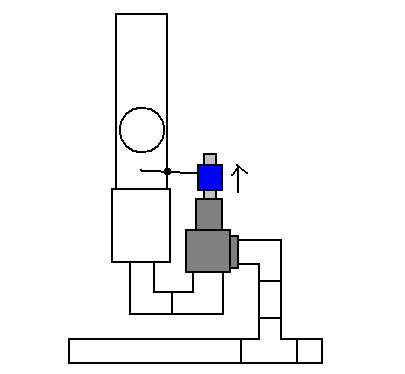

What sort of lever did you have in mind?
Something like this? Or more complex?

Originally I was going to go with an overcomplicated design but I reworked it into one similar to what you have with a pushrod. The only difference really will be the chamber. It will form a base that can hopefully allow me to adjust the angle.

This is what I had in mind originally, way too complicated. I will use your idea.

Thanks for using my idea, I think I'm going to do something similar, involving an 1.5" QEV...

For a 1.5" QEV though, I don't think drilling more holes in the slide check will be enough. You might need to pilot the main QEV off a smaller one first.

The QEV already has a second valve built into it for piloting, and the second valve has 1/8" threads in the pilot port. I've measured the pilot volume of the second valve and its under 10cc, so hopefully I won't have to do any modifications to the slide check valve.
But I'll be prepared. I've just recently acquired five 1/4" QEVs so one of them could be added to help pilot.
