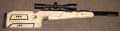

Update!
http://i210.photobucket.com/albums/bb12 ... ATXHC3.jpg
Don't read a lot into the lines across it, but perhaps for the one across the base of the butt. That's a possible line for the lower edge of the stock, partly to cut back a little weight, but also to give it a more interesting profile.
The new stock is 2" shorter than the old one (so the rifle is only about 37" long, adding to it's carbine nature), which can be done comfortably by virtue of the changes to the grip shape - that means my left hand can therefore support the rifle further forwards, making the rifle appear less nose heavy.
A side effect of that means the scope needs to be moved forwards (into the next stop pin hole) to get the right eye relief, so it now obscures the loading port a hair, but that's no big deal.

That looks really nice Rag good work.

Nice stock.. If its a trial stock and you plan on making another ,I would invest in some quality wood. You could use oak or maple ,you can get that wood at any hardware store. Birds eye maple is great,if you can find it. Oak will finish up really nice also..Thats what I would use. If you cant find oak or maple or any other kinda wood in 2x4 you can glue up some smaller stock to build up thickness. When you are carving out the stock I find an angle grinder works good for large areas..As for tight corners, the dernal would work nicely. Files and sandpaper will also be needed..If you plan on going for a military look you could just use crap wood and just paint it. :salute:

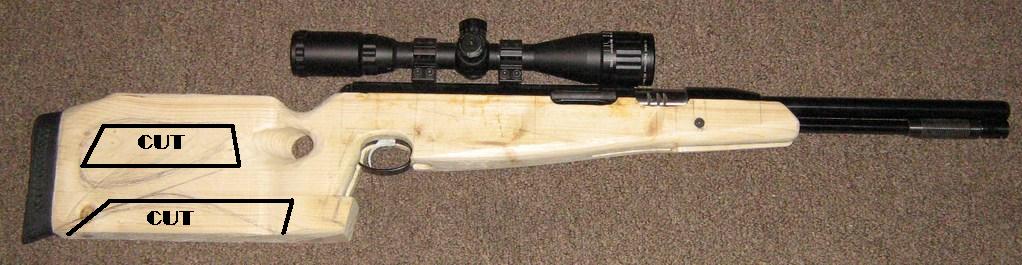

that looks very comfortable, and it would look cool if you cut off the bottom section you marked out and the center section you marked out, then it would be similar-ish (not really :?: ) to the stock on an SV-98

nivekatoz wrote:Nice stock.. If its a trial stock and you plan on making another ,I would invest in some quality wood. <snip> If you plan on going for a military look you could just use crap wood and just paint it.
The plan is a nice wood, rather than just painting it. This is a rifle I'm planning on slowly modifying and customising in it's own unique way (firstly looks, but I've already got a couple of designs for improved internal parts), rather than going for any particular look.
Eventually, I want it to be something unique that feels, looks and shoots great, and is well worth keeping.
ALIHISGREAT wrote:It would look cool if you cut off the bottom section you marked out and the center section you marked out.
It's a plan I'm considering, but I'll have to redefine the centre section quite a bit smaller to make sure it's strong enough to survive knocks.

I think this would look cool myself.
