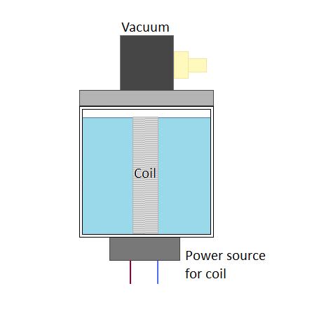

Thank you everybody. In terms of quickly boiling water, I have altered my design.
Therefore, my new idea uses both of these principles (Figure 2). It has an internal coil so that all heat will be transferred directly to the water and no heat will be lost to the air. Furthermore, the attached vacuum with remove all the air and allow for the water to boil faster.
Any further comments or suggestions will be appreciated.
In regards to my coil idea on the outside, I considered what Biopyro stated above. Thus, it would be more logical to place a heated coil inside the body of water.Biopyro wrote:It would just add an extra heat source, of which half of the heat would be radiated into the surrounding air. The most efficient convenient way is a pressure cooker, since it stops the energy evaporating out, and it's insulated to prevent it radiating out.
Likewise, I considered the idea of placing water inside a vacuum. This makes sense for this idea is seen in application at higher altitutes (just look at cooking instructions for higher altitudes).LikimysCrotchus5 wrote: It takes about 100 degrees Celsius to boil water at 101.3 kPa. Now, if you create a vacuum, the intermolecular forces overcome themselves and they rip apart, causing the water to boil because there is no pressure holding the molecules together.
- Figure 2: Quick water boiling revised
- Instant Boiling Redux.jpg (12.44 KiB) Viewed 3445 times
Seems like it would work but what are you trying to get here?
Do you want steam? Because the vacuum will surely suck that out. But it will make it boil fast for sure.

if its for a gun, drawing a vacume is pointless. You just vacuming it only to bring it back up to atmospheric pressure (less).

I stated earlier that this was just a project I wanted to do to see if I could boil water very quickly. Steam was not in mind.
Thanks for the help everyone.
EDIT: I came to the realization that if the vacuum was removed, this would essentially be a small fire tube boiler. To whom it may concern, this could produce steam if you remove the vacuum.
Is the lower boiling temperature due to the vacuum ok for the project?

of course it isn'tis the lower boiling temperature due to the vacuum ok for the project

I am not quite sure what is being said here. Perhaps the question needs to be reiterated.POLAND_SPUD wrote:of course it isn'tis the lower boiling temperature due to the vacuum ok for the project
Producing a vacuum reduces boiling temperature.mega_swordman wrote:I am not quite sure what is being said here. Perhaps the question needs to be reiterated.
Rather than boiling at 100 degrees C, it will boil at say... 80 or 90 because of the lower pressure - Removing the vacuum will stop the water boiling.
The question is... do you want boiling water (That is, water in a gaseous form) by any means - and that which only exists in a partial vacuum - or do you want water at 100 degrees C?
