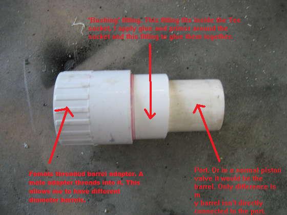

Do you mean:How would You get a 2 inch barrel that far the chamber without it being all over or not properly sealed
How do you get the barrel to go inside the tee with it still being sealed?
Well you can do what jimmy101 said, or you can do what I did with mine:
(see diagram below)
In a basic barrel sealing piston valve, the barrel goes all the way through the tee and it is glued in place as jimmy101 described. In a piston valve where you want interchangeable barrels, you can do what I did:
Take a piece of pipe the same diameter as the barrel, cut it so when glued in the socket, the 'port' of the barrel, or where the piston seals, is about in the middle of the tee.
Glue a bushing the same diameter as the tee, to one end of this length of pipe. Then glue a female threaded adapter over the bushing. (Your barrel will have the male threaded adapter glued to the end of it.)
Apply glue and primer around the tee's socket and around the bushing exposed (see diagram), push fittings together twisting them a quarter turn. Hold together for 30 seconds. Okay, now the 'port' or the place the piston seals against the barrel, should be roughly in the middle of the tee. If you want a difference sized barrel, simply put a male threaded adapter the same diameter as the female one, on the end of it. Now you can have multiple barrels.
If you still need help understanding, just ask. Read over the instructable again if needed also.
Edit: Sorry about the writing on the diagram, i'll put up another one shortly.
- Fig 1
- a.jpg (27.26 KiB) Viewed 1230 times

I plan on doing exactly what I show on that diagram but boreing out the inside the reducer so the barrel will slide right into the tee will this work?
I'm trying to follow this part but I feel like a 4th grader (more of a hands on person)
Get two 50mm x 40mm PVC bushings and cut 1cm off the end of one of them. Cut a piece of 40mm PVC pipe 15cm long and solvent weld one of the bushings to the end and the other bushing just above the other. Then solvent weld the female socket adapter onto the bushing on the end of the pipe. One bushing should now be inside the adapter, and the other just above it.
So get 2x 2" to 1.5" bushing (reducer), Is the 1cm cut off necessary? cut a 1.5" piece about 6" long and solvent weld it to one of the bushings. What do you mean by "above".
Thats where I got from your description I'm not sure how your using the other bushing unless your using 1x 2" bushing and 1x 1.5" bushing rather than a 2x 2" to 1.5" reducer Please let me know.
I got it all except how you are getting the 1.5 segment glued in are you just glueing it in the upper lip part of the Tee??
I think I've figured this out, thanks. =)
