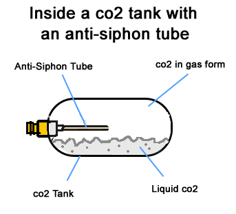

Only true if your anti-siphon tube was installed by an idiot.spudkilla wrote:The anti siphon only works when the tank is horizontal and facing a certain angle.
Hint: CO2 is roughly twice as dense as water. A *FULL* CO2 tank is less than half full of liquid CO2. Result? As long as your anti-siphon tube goes to the center of your bottle, it will work, period.
And yes, I have a dozen or so of 'em in my garage as we speak. When I was young and spry I too was a paintballer. That's what got me into this little hobby. I *tried* to educate the masses. Too much testerone and too many idiots. They'd do the math but forget that CO2 is denser than water. Blah blah blah....
Here's what your picture SHOULD look like:
- anti-siphon-co2-tank.gif (8.19 KiB) Viewed 2597 times

An anti siphon tube is meant to give you only liquid CO2, like used in fire extingishers to add as much CO2 to the fire as possible in order to "choke" the fire.([For refrence!]Standard CO2 cylinders come in two types. Gas and Siphon. Gas cylinders stand upright and releases gas from the evaporation liquid when the valve is opened - this type of cylinder must be turned upside down in order to obtain liquid CO2. Siphon cylinders have a tube from the valve to the bottom of the cylinder so that when the valve is opened liquid CO2 comes out without
needing to invert the bottle. Fire extinguishers are of the Siphon type and Bar/Pub Beer Gas Cylinders are of the Gas [url]type.http://soadahclub.vox.com/[/url]) But it does not help me, i want to know what source of compressed cas i should use, i am really in need of an answer, just stay on topic until i have an answer then do what you want... So again: which of the following is cheepest, safest and most powerful?:

No, that is a siphon tube. Siphon tube. Anti-siphon tube. They are exact opposites. One is designed to get nothing but liquid (the siphon tube). One is designed to get nothing but gas (the anti-siphon tube).john bunsenburner wrote:An anti siphon tube is meant to give you only liquid CO2,
