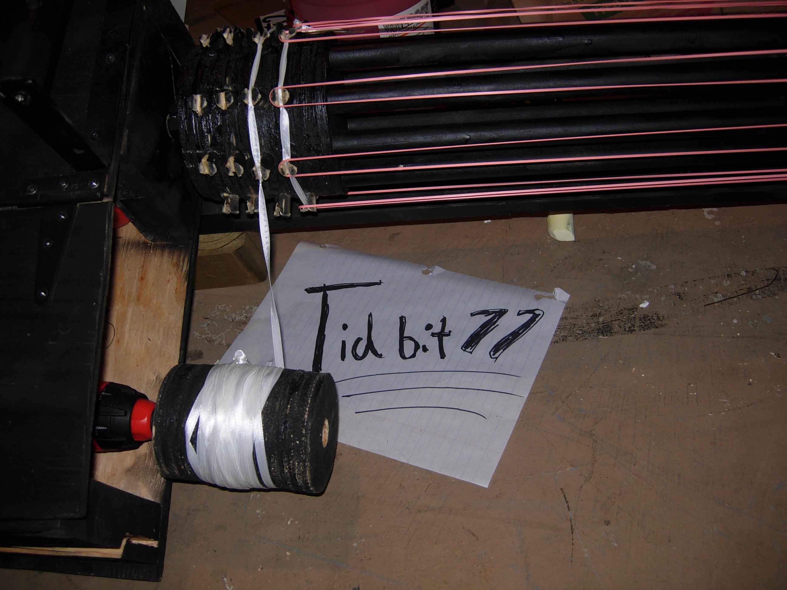

Can you give any details on how it works? Seems pretty badass.
yes it seems cool, but I'd appreciate it if you just took a real picture of it.. that way I wouldn't have to feel bad about doubting that its really yours.

Hmm. Not saying that you can't have built it, but these repeated "I can't upload a video" posts aren't earning you any credibility, and it sounds like you're trying to dig yourself out of a hole.
I'm prepared to give you the benefit of the doubt, but others might not be quite so accommodating.
On the flip side - if it's not your work, then the best time to own up is now, because the longer you leave it, or if you're found to have plagiarised someone else's work, then you're never going to get the credit back off the forum.
We had someone try to plagiarise a reasonably well known internet homemade airgun a couple of years back. Tried all kinds of stupid excuses when he was found out (it's not mine, it's my friend's... etc, etc), and destroyed any hopes of credibility he might have once had. Very stupid thing to have done.

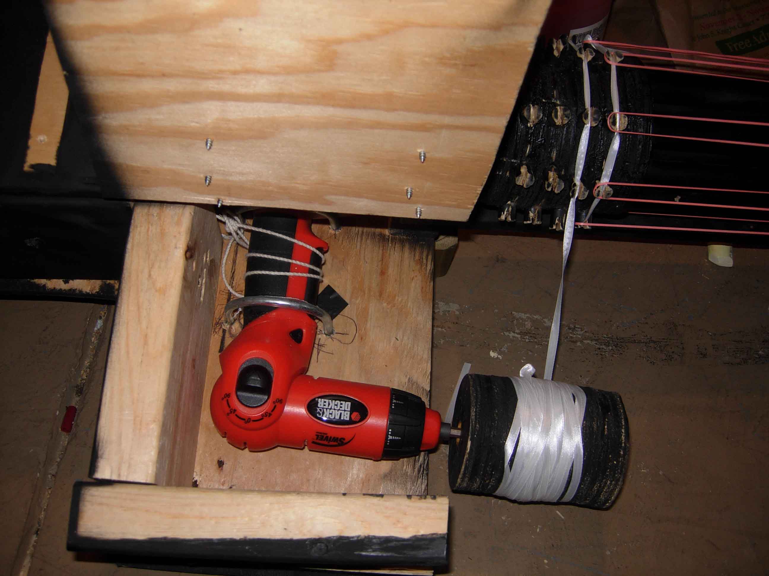

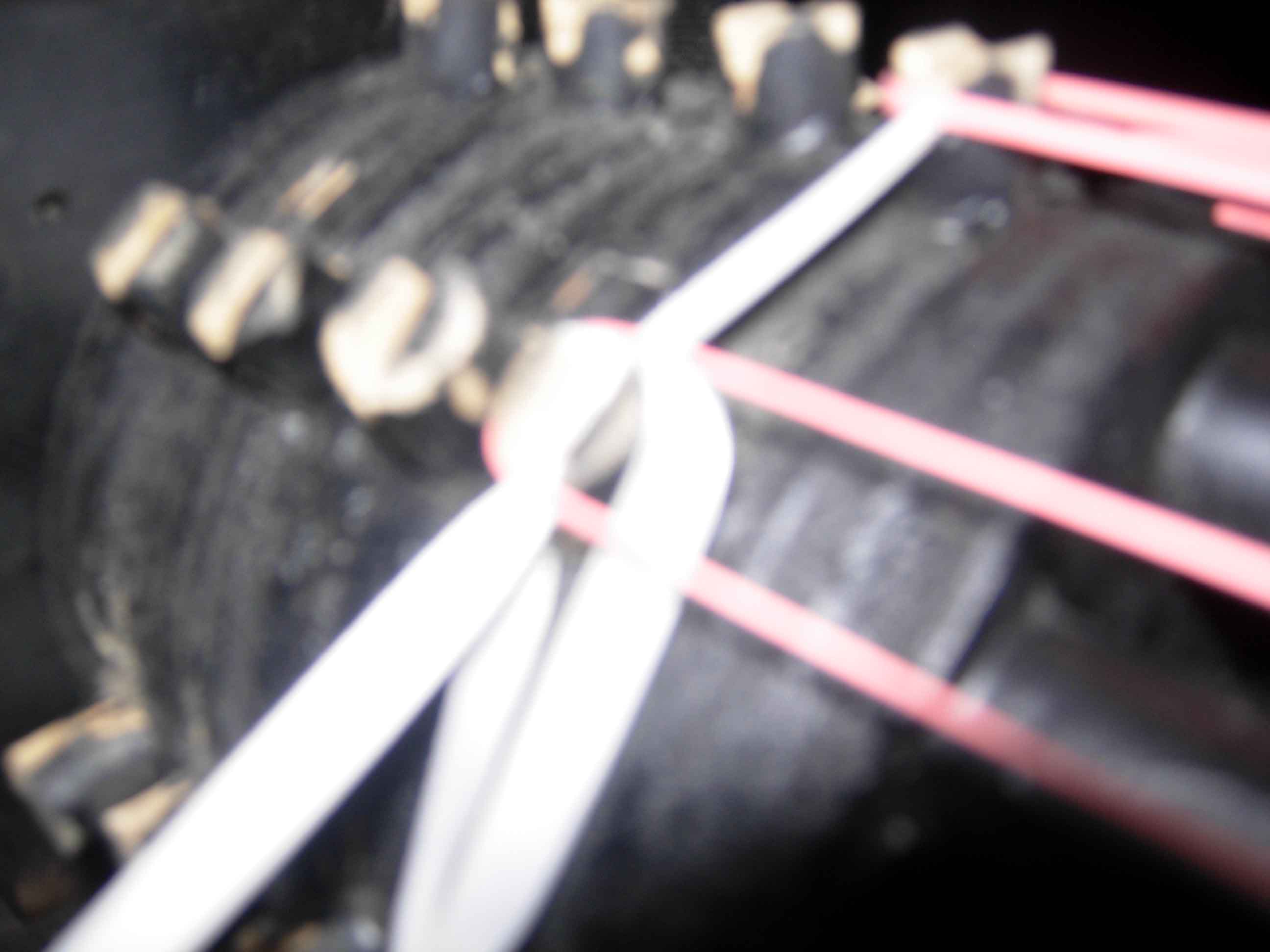

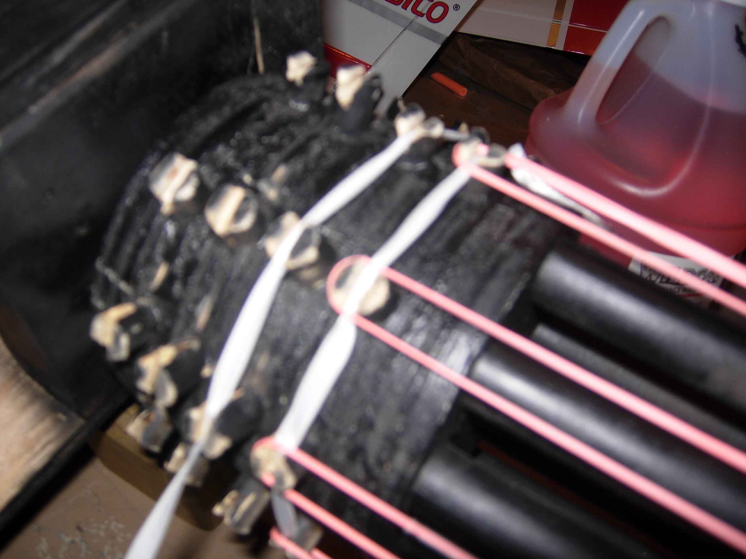

Here's how it works:
(sorry, the first picture is at the bottom of the post)
Loading:
1. ribbon is loaded onto a spool, which is chucked in a small drill.
2. the ribbon is attached to one of the pegs on the barrel, and than is inserted into each slit in the pegs
3.rubber band is loaded over peg
4. repeat steps 2 and 3 up to 2000 times.
Firing:
1. The drill is turned on by means of pushing a handle on the rear of the gun
2. As the ribbon is spooled up, the rubber bands are lifted out of the slots in the pegs by the ribbon, allowing the rubberband to fire
3. The spooling action spins the barrel and moves the next rubber band into position.
And thats pretty much it, it is a simple process, but it is one that is hard to perfect, mainly because string, and various other materials I tried would simply slice the rubberbands in half. This process is simalar to the way other rubberband miniguns operate, just done on a larger scale. (The lego rubberband gun video is mine, and operates on the same principle, I was using it to gain experiance with rubberband mini guns, notible people who have build lego miniguns are on youtube koesiggneggccr007 and Kaspall)
Loading:
Firing:

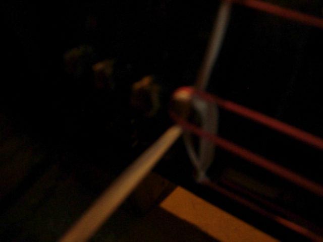

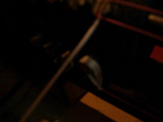

- the rubberband has fired
- how the mini gun works 010.JPG (34.41 KiB) Viewed 2851 times
- the rubberband about to fire
- how the mini gun works 009.JPG (35.45 KiB) Viewed 2851 times
