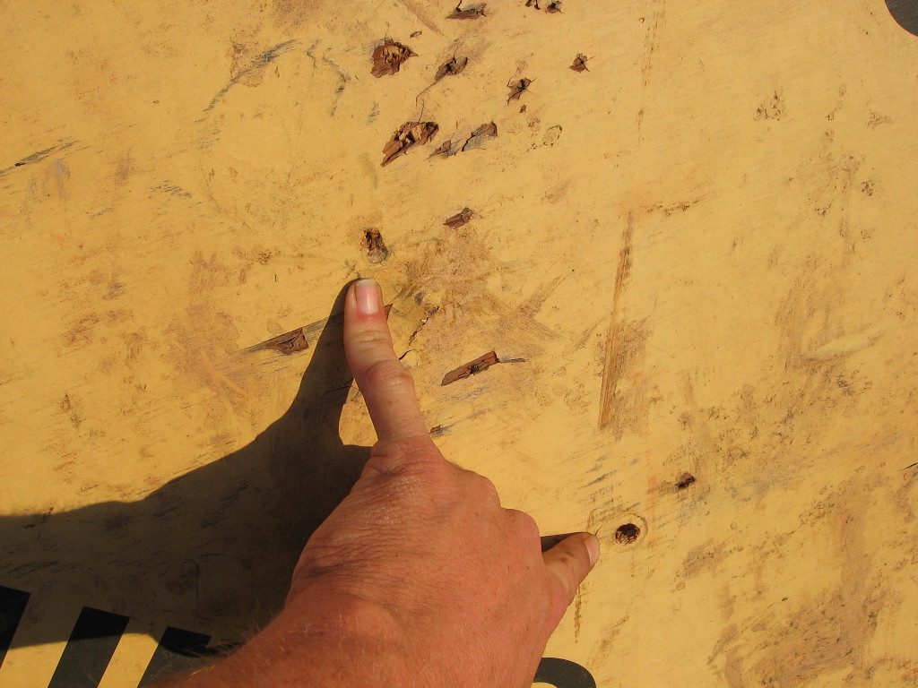

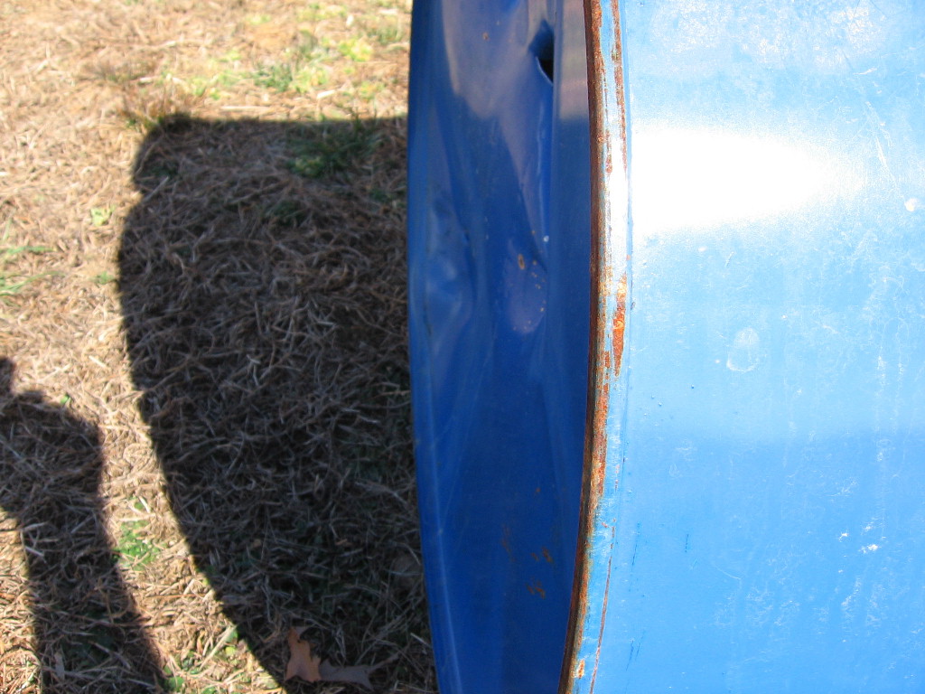

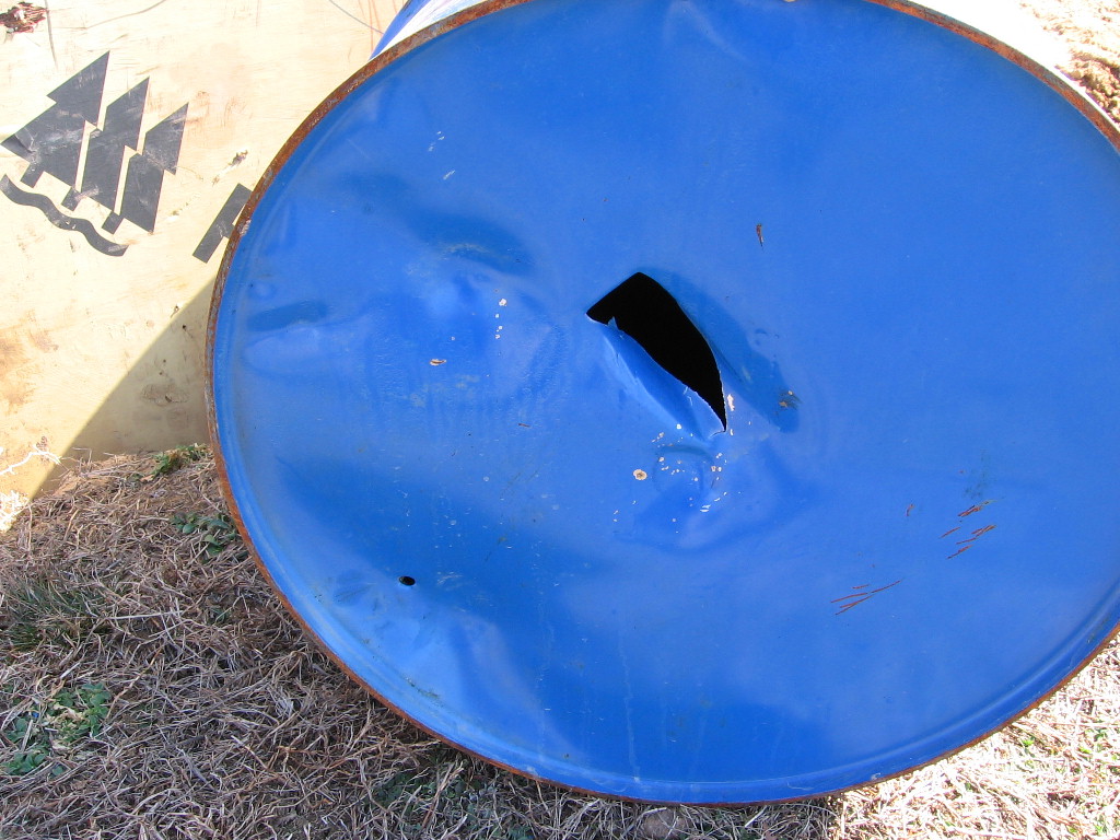

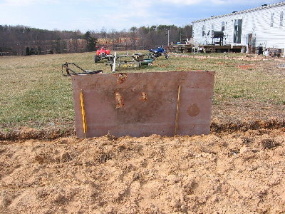

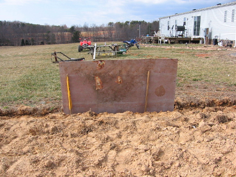

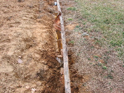

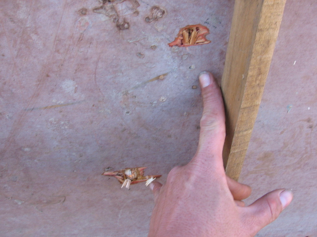

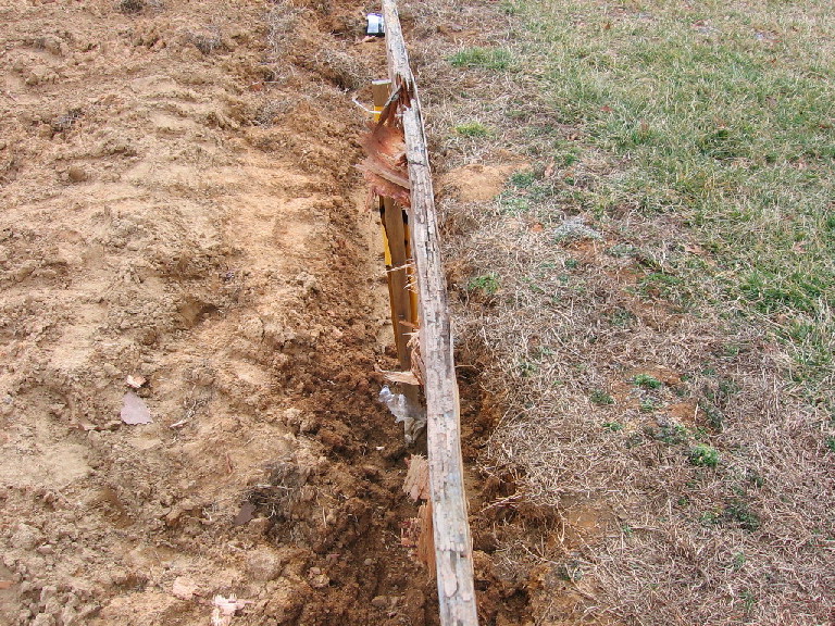

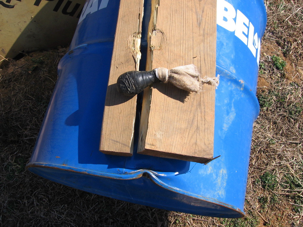

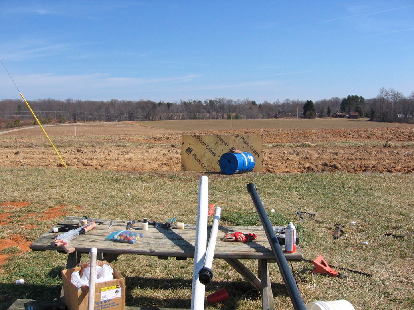

Finally had some nice weather so I got to poke holes in stuff...
Note the captions with the pictures...

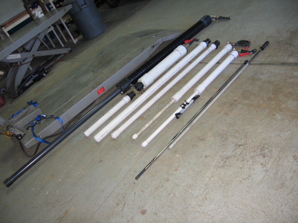

- from the left, my GB gun, my modular toolie valve gun and short 2" barrel, the 2.5" tennis ball barrel, the 1.5" barrel, my personal coax 1" barrel 2" chamber, coax I made for a coworker ( check out his bike pump accesory, 40 pumps=55psi, he uses it indoor with a target trap and superbounce balls), and my 2-piece conduit and coupler ramrod....

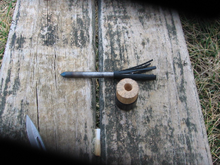

- the blowdarts, 1/4" steel rod 4" long, sliced up rubber tube as a flight, and a 1.5" long x 1" diameter wood "sabot", with a 1/4" hole 1/2" deep, the rubber feathers are folded forward when loaded.... the sabots also work great for arrows.... I went to my long range area(not pictured) and at a 25degree angle the arrows are way into the woods, never found them... blowdarts and arrows were fired from my small coax...125psi
You have a nice range there. What exactly is picture 12?

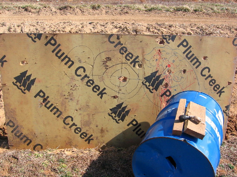

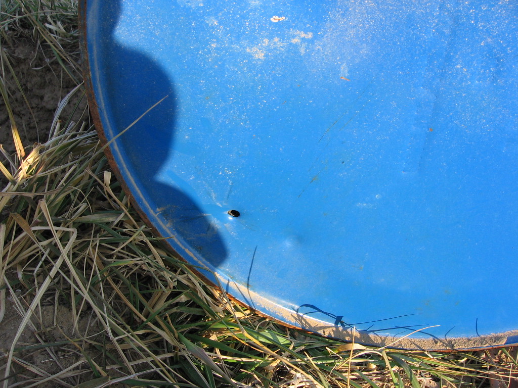

more pics....
All shots were with 100 to 125 psi...
That's some nice shootin' there Jeep. I'm ready for that Spudjam...looks like you've got the space for it.
