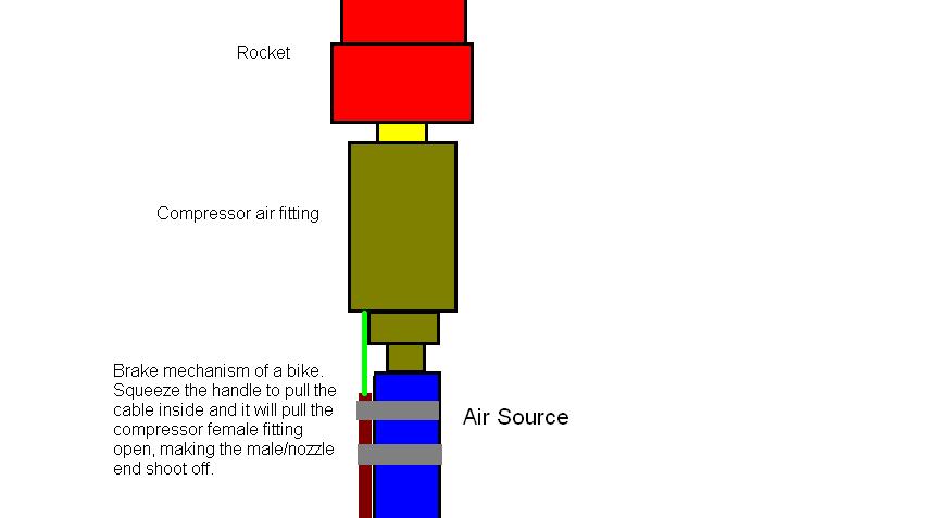

I thought of this release mechanism a while back but I never used it properly. I don't know how hard it will be to use at those extreme pressures because I made this thing to work at about 150-200.
Anyway it's pretty self explanitory.
Good luck with the build.

That is almost exactly what I suggested I think it could work at higher pressures too because of them being seen on shock pumps (mine included). I like your diagram :)

Mitchza89
Posts: 1056
Sorry Sticky, I only saw your post just after I posted mine. Great minds think alike :D.
