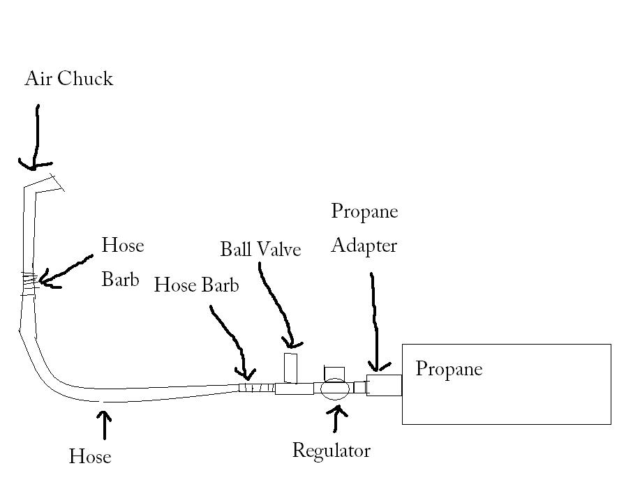

I quickly made this drawing in paint to show what im thinking about doing. Would this work, or do I need to come up with a new design?

is your regulator/propane adapter made from parts from a propane torch. if so, there won't be enough flow. If not, I am interested to know what fitting you used so I can find and abuse one myself.

No its not from a propane torch its a really neat adapter I found online on Acehardware.com, The adapter screws in to the tank just like a propane torch but at the other end its a 1/4'' male NPT Fitting. So using this would I get enough flow, and would closing that ball valve to seal the hose, would that act as the chamber and inject the propane?

If your regulator is not adjustable, it's most likely set to something like 1 psi. I would just bypass the regulator entirely and just monitor the pressure with a gauge. Any safe cannon should be able to use unregged propane without risking a rupture.
I used a reg like that in an *almost* homemade scuba system, there's no info of the pressure on the reg, but it was low enough for me to breath in on the end of the tube
Look at the hoses that were attached, mine were rated to 1 psi
so there's a good indication of the pressures used.
Unless you want to use it as an inflator for beach balls, look elsewhere

that tiny hole is a hasle. that's y i saw it off. u get a much higher flow. this has been discussed many times before. i'm also in love with propane and use it often. it's great for pressure and combustion and it's very cheap. i usually build the blue cylinder into whatever launcher i come up with.i drew a simple little pic a while back for some guy and hopefully it can help u too.http://www.spudfiles.com/forums/can-u-p ... 16383.html

I say you should get rid of the regulator or use one made for compressed air (air compressor) maybe add a small metal expansion chamber before the tire chuck if you have problems with the piston not seating at first.

I have a regulator that is made for compressed air, and it is adjustable. Going to try that propane system today and see how it works. Ill let guys know how it works out.

Bad news, I tried that plan I drew up and it didn't work. I connected my propane tank and then I Set my regulator to 50 PSI to start out, Opened the ball valve to release pressure into the hose, closed it, then attached my air chuck to my shrader valve. It hissed and that was it no pressure coming out into the chamber what so ever. I know its not a leak on the gun because I connecting it to my friends air compressor last night and it sealed just fine. I'm confused what am I doing wrong again?

So you have a pressure gauge on your cannon to tell whether there is actually pressure going in?
Try holding your hand over the barrel (or safer would be a feather) to check for any flow out of the barrel.
The other possible problem is that you are not setting the chuck on right. I would suggest using quick connects or something like that, because shraders and chucks are quite imprecise.

Yes I have a pressure gauge on my chamber. There is pressure coming out the barrel when I attach the air chuck, But when we tried my friends air compressor it had no air leakage out the barrel. Someone stated that I was filling it to slowly and it wasn't sealing the valve. That's why I mad that plan so it could inject it all at once.
