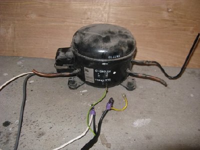

Update: Compressor freed
Ok, I have freed the compressor from the fridge, and once again, have a few questions.
1. Which tube is the intake and which is the output? (I know the crimped tube is where the freon was put in)
2. Once I get things set up, do I need to do anything with the ground wire (green) or can I just icap it?
I am planning to install a switch between the grey and yellow wires; that is where the thermostat switch was.

most likely it is oil
there will be more of it in the compressor... try not to spill it as it lubricates it and helps in transfering heat (so it prevents overheating to some extent)
fridge compressors create a sort of oil mist when they run... so air is lubricated (which is a good thing) but to a much greater extend than normal shop compressors...
there are several ghetto ways of stopping some of it, lol it's hard for me to explain it but it involes using a vertical lenght of an airhose and gravity will do the rest (some of the oil will condensate on internal walls of an air hose and gravity will bring it down - I am not sure if this helps you to understand what I mean but it's really simple)
if you want to you can even add an oil filter

just wire it and turn it on... the one that is sucking air is an air input
at least that's how I determined that
every electric device should be grounded
so don't scrap it - it's there for a reason...

I assume that you have sockets with grounding in the US ?? the cable has three wires so I assume that you do
if you have salvaged the plug as well then what is the problem?

if there are three wires then the socket should also have grounding...
( I suppose you it should look like this one -> http://www.hdinterconnects.com/images/us-3-pin-plug.jpg and a link to wikipedia article on plugs&sockets -- > http://en.wikipedia.org/wiki/Domestic_A ... nd_sockets )
just join the wires from the two cables (the one sticking out of the compressor and the one with the plug)
use a water-proof connection box aka a junction box to join them safely ( http://www.made-in-china.com/image/2f0j ... on-Box.jpg )
ohh and it's a good idea to buy a switch that is also water-proof
EDIT
links added... to all in all, you should have a 3 pin plug and one of them is ground
plzz read the article if you have any problems... hope this helps... I am out it's 3:40 AM here

Seriously What are you doing? http://www.hdinterconnects.com/images/us-3-pin-plug.jpg
3 Contacts and you have 3 wires.
The 2 vertical ones are you pos and neg, the round one at the bottom is ground. Solder it up and your good to go

Once again, I know which ones are positive and negative, I know how i will set up the switch with them and all that. When you say "solder it up", that really doesn't help considerering I still don't know where to attach it to. (do I just connect it to the compressor's shell?)

the compressor case is already grounded...
that's why there is grounded wire in the cable...
use teh junction/connection box to connect the wires sticking out of the compressor with the ones sticking out of the cable with a plug
the plug is still connected to the compressor, I never cut any wires. So this is what I'm doing. The negative wire from the plug is already connected to where t needs to be, the ground wire from the plug is not connected to anything, and the negative wire from the compressor was connected to the negative wire of the plug by the thermostat switch, witch I will replace with some kind of on/off switch.
So, I am assuming I connect the ground wire from the plug to the body/shell of the compressor?

so the cable with the green (grounding) wire is the one with a plug ? and you don't know where to connect it ??
(I assume this is true becasue otherwise it doesn't make any sense... or I am missing something)
so either there should also be a green gounding wire in the cable sticking out of the compressor and you should connect it there... or you can solder it to the case
well anyway... I just want to stress the fact that it is really simple to build a fridge compressor.. I know that after reading this thread and lenghty explenations some people might get the idea that it's quite the opposite but really it's very very simple
