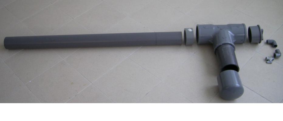

The picture of the entire cannon is here though. [/img]
The cannon. It is pictured with some sort of elbow to attach the ball valve, but this has been changed subsequently to an air hose

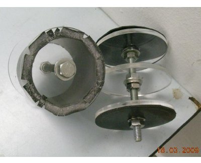

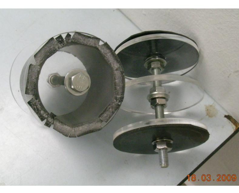

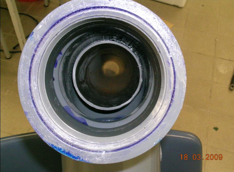

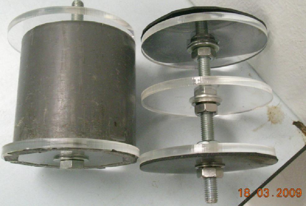

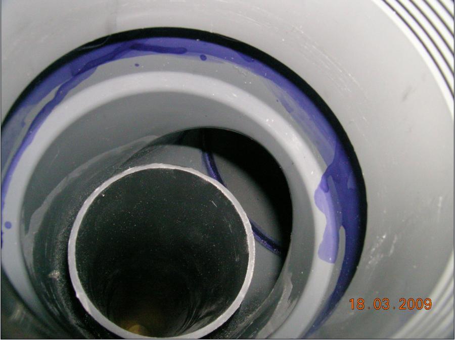

Here are the pictures of the piston and the inside of the cannon in question:
Another view of the inside of the tee. Might be a bit disorienting at first glance though.
Another view of the pistons. The peel & stick sandpaper on the "fake" piston is now clearly shown.
The pistons. The one on the right is the actual one that I intend to use, the other one is where I'm mounting the peel & stick sandpaper on.
The inside of the tee. Note that the sanding is still not finished yet.

Ooh, a plexiglass piston.. make sure you make a good bumber and don't let it get too hot, or you'll know about it.

Pistons dont get hot from use unless there's some insane friction going on.
Those pistons look nice!
A spring isnt needed when you fill from the back. A bumper, however is VERY important. You could smash your nice plexiglas piston in one shot, or even worse, have it hammer through the back of the T.
Anything soft and squishy will do as bumper.
I'm looking forward to seeing it in use. :)
