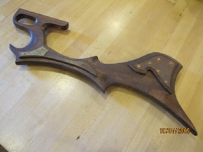

Hello all
(first post here)
Let it be known that i DID indeed read the rules and noticed that kicking up old threads is generally frowned upon, however i have lots of experience in this field and feel as if this needs saying.
PRO TIPS FOR EPIC WIN STOCK:
a) use a hard wood- the softer, usually yellow pine, you find in 2x4's is soft and doesn't sand well if you want a GLASS SMOOTH surface. every area will have a different hardwood selection, but you should look for the distance between grain. (more lines on the wood usually = better sanding finish)
b) i HIGHLY encourage this level of finish on your spudder... however... be aware of the time investment before getting started. i would suspect that this particular stock took upwards of 10hrs to get to this point... with 90% of the time spent sanding.
c) know how to truly use sand paper. start with a rough grit (80) to knock out all your chisels marks, and progress thru higher # values (400+ for a super clean finish) . cant stress this enough... sand sand sand... then do it again.
d) FINISH IT RITE- you just spent HOURS on this stupid scrap of wood... triple layer your stain and finish with a clear polyurethane or wood oil.
HAPPY STOCK BUILDING ALL!!! take pride in the fact that you took a bunch of pipes and fittings... and turned it into a true work of art. I salute you and your craftsmanship jook13
questions? comments? flames?? shoot me a pm
Pic=resume... one of my most recent stocks for a spring-powered steam-punk themed air-soft rifle.

Wow man that stock is EPIC. It's okay to kick this up. I think they were some good tips.
If you intended to make my eyeballs pop out at first sight... congratulations!
That truly is a 'Win' stock. I agree with you on all the points you have added to this guide.
I think, maybe if you want/have the time, lets write an in depth 'dummy's' guide to stock making.
I have seen a crapload^1of launchers in my time of lurking through the web; there are only a handful of launchers which have been finished to this sort of standard. This may be because people simply don't care about aesthetics/appearance of their creations, they don't have the time/tools/funds, or they don't have the know how.
Although this guide is great^2, i think it doesn't go really in depth. I think if one was written which induced everything here + measurements, examples, and ideas how to make it look 'different/awesome', then maybe we could see a few more well finished launchers.
Also, just an idea, if this was done i think a contest would be in order.
