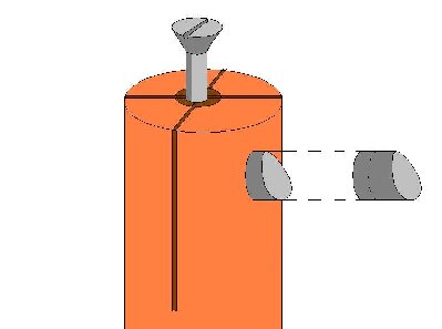

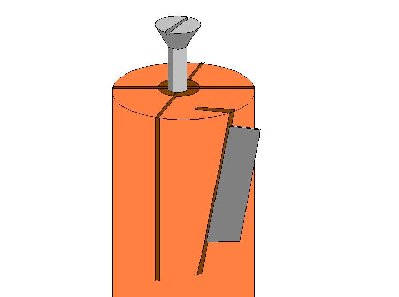

would there be a better alternitive to using nails as cutting edges?
Forever dreaming...
Netherlands
Posts: 3497

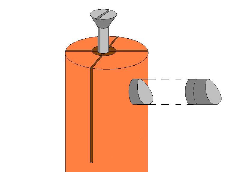

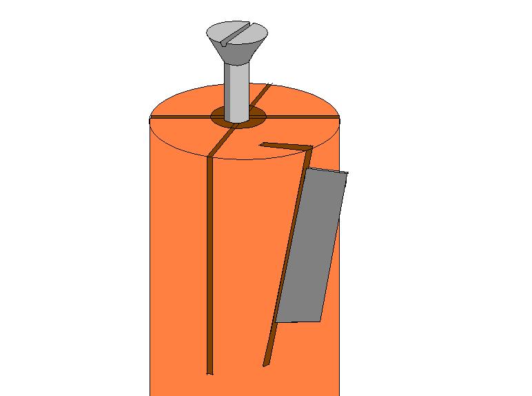

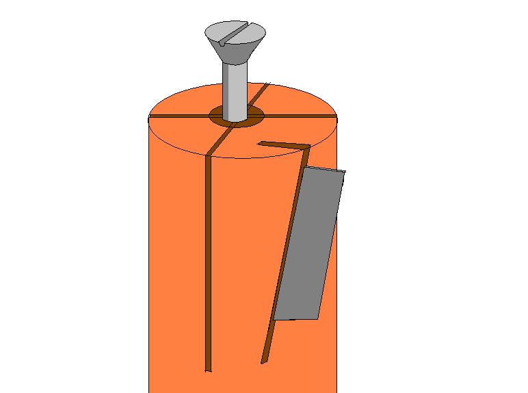

You could cut the nail at an angle and sharpen the edge like a chissle.(sp??)or try breaking the blade of a metal-saw into small pieces and glue them into the dowel ( first cut) at the same angle as the spiraling tape..
Adjustable head:
drill a small diameter hole straight into the top.Then saw deep slits into the head of the dowel and screw in a long woodsrew to open up the head. then insert the cutting blades into the head.
This way it's cutting depth is adjustable.
Hope U get what I mean.My english fall short when I have to explain stuff into to much detail.
screw to push out the &amp;quot;fingers&amp;quot;.<br />Piece of metal saw as cutter.

Seen here is adjustable head with angles piece of nail glued into place as the cutting tool.This idea seems to be the best to me
