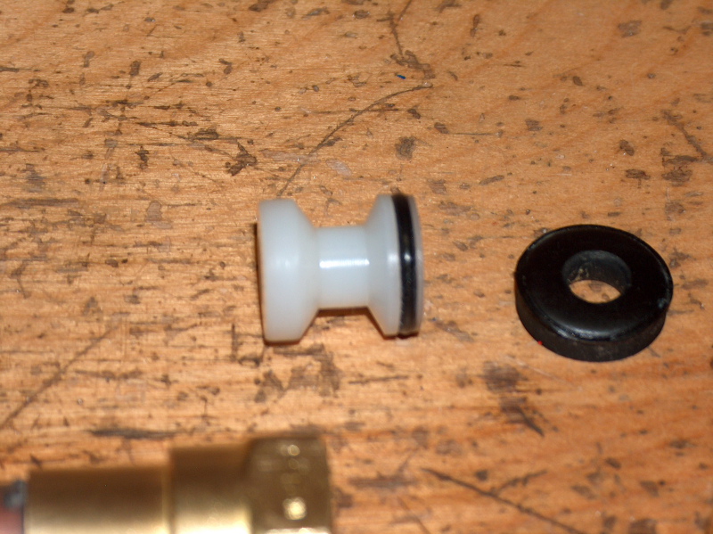

Hollowing the piston is fine, but you should seal off the hollow portion, or you will be increasing piloted volume.
It has that "familiar" look. :)

Gippeto wrote:Hollowing the piston is fine, but you should seal off the hollow portion, or you will be increasing piloted volume.
Sorry for all the questions everyone! I've made too many mistakes to redo anything else. :lol:
Can I get away with using a pilot volume this large if I vent it with a 1" sprinkler valve? Or maybe I should use a 1" ball valve instead, the sprinkler might restrict the flow. Anyways, I need a large pilot volume to house the extra large bumper.
LCTChamp
Posts: 188
Joined: Thu Aug 21, 2008 8:01 am
A 1" sprinkler valve is a way better pilot valve than a ball valve of any size. With o-ring seals you could get by with the extra pilot volume.
jmeyer1022
Posts: 200
Joined: Sun Nov 09, 2008 4:50 pm
I'd really suggest going smaller, 1" sprinkler will be fine. You wouldn't need such a big bumper if you cut the space down that the piston slides because it wouldn't have time to accelerate.
