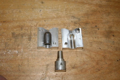

Wrong mold, that one's for 1/2" type M copper.
This is the mold before being reworked;

Can you do a how to on those slugmolds?In case you already have, where can I find it?
I mean..I get how to make a splitmold, but that nose is awsome!
how did you do that?

Brian, I'm not sure which mold you're referring to, but the nose on small one for 1/2" copper was made with a modified HSS spade bit.
http://www.spudfiles.com/forums/easy-sp ... 17366.html
The nose on the large mold was made using a 3/4" round nosed, carbide router bit.(This mold was made on the lathe.)

I've reworked the slug mold again to place even more of the mass in the front of the slug. We'll have to wait until I fire some to see if there is any improvement.
