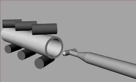

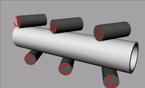

Here is my idea I have... The cutter remains stationary while the pipe rotates . Vice versa could be done. Basically only the front two rollers would need to be powered while the others just strudy. The rollers would need to be coated with something like rubber so that they can "grip". Very similar to the nail gun someone introduced (Cant remeber if it was B the B or Rambo). By simply adjusting the angle of these rollers you could adjust the twist rate.
<img src="http://www.spudfiles.com/uploader/uploadFiles/R-01.PNG">
<img src="http://www.spudfiles.com/uploader/uploadFiles/R-02.PNG">
<img src="http://www.spudfiles.com/uploader/uploadFiles/R-03.PNG">
Tell me what you think and if you have any improvments. After making these drawings I found many things that can be made simpler.

Pimpmann22, was the thinning of the cutter mount just for show? Or did you make 1 that way? Powering the rollers will be tough because that makes 2 drive connections, if you use 1 moter for both the 1 closer to the motor will probly chatter due to haveing to pull a 2nd in line,(i think).
I think turning only 1 will be better.
Now how can it be made to pull 1 or the other evenly/steady??
I do beleave that will be the hard part, ummm, well, dam now i'm gonna have to build 1, (the 1st part) just so i can build the puller, i need the 1st part in my hands!!!
I will start middle next week when i get caught up with the spring rush.

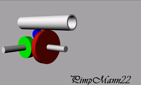

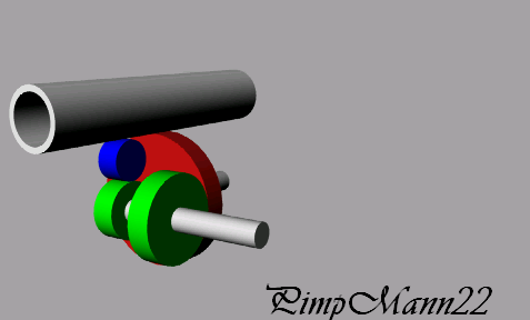

first off, thanks to pimpmann for this, he's a god =)
so, heres whatt you're seeing in these pictures
red-gear which rotates the pipe
green - gears coming off the red (main) gear, which hook into the wheel
Blue - Friction wheel which keeps the pipe moving foreward at a steady rate(original idea of using a tighteningf rope was scrapped and replaced with this
not pictured-
-small rollers (angled approx 45*) to keep the pipe moving straight, and on path
-crank/motor that gets the whole thing movin'
not pictured-
This is Pimp posting these pictures... The "real" poster will edit when he returns.
