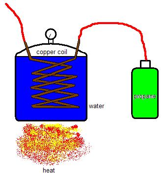

Last night I started brain storming it and came up with an idea.
I have an old pressure cooker somewhere. I could put a coil of copper tube into the cooker then fill it with water. have my propane running through the tube.
- something like this.....
- propane heater.JPG (21.88 KiB) Viewed 3049 times

It'd work, but it still carries the risk of ignition of leaks.
Also, it might actually encourage delivery temperature (and so, pressure) to be above standard levels.
You could just use an expansion chamber, then your firing chamber. There would only be liquid in the expansion chamber, so that would be very cold, but you would still get a high pressure. Your flow wouldn't be excellent though. I suppose your solution depends on the portability you want...

Nope, really won't work. Just dropping the propane tank in an unheated bucket of water will work better.
You need to get heat into the liquid propane. Adding heat to the already gaseous propane won't do much. It won't increase the pressure in the system since that is controlled by the temperature of the liquid in the resevoir.
Heat transfer via the gas from the heater back to the liquid in the tank will be very inefficient. So the heater won't do much of anything to the propane resevoir.
To make it work as drawn you would need to invert the propane tank and feed liquid propane into the coils. Even then the pressure in the system will still tend to be regulated primarily by the temperature of the liquid propane in the tank and not by the temperature of the coil. All you would accomplish is that the system would supply gas faster but the pressure would still be based on the temperature of the liquid in the tank.

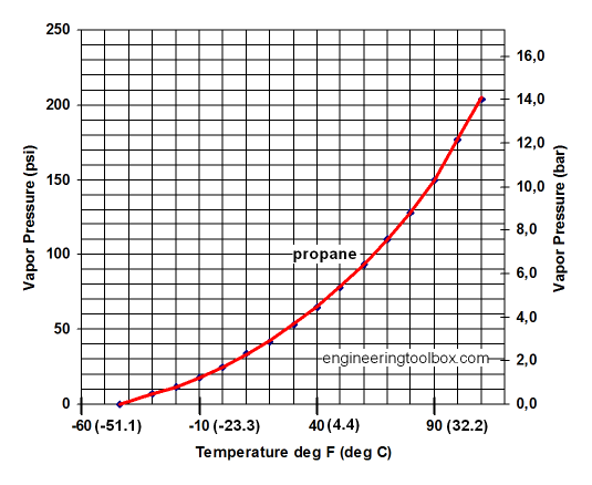

The data is easy to find online. Here is a vapor pressure graph I just snagged. The pressure is directly related to the temperature.spudmanb3 wrote:I think (Don't Trust me) That propane is generally around 120-150psi in the bottle. Again, don't trust me.
-James
- Porpane vapor pressure graph
- propane-vapor-pressure-diagram.png (28.98 KiB) Viewed 2964 times

Or, you could just use the graph in the SpudWiki page on Propane;Technician1002 wrote:The data is easy to find online. Here is a vapor pressure graph I just snagged. The pressure is directly related to the temperature.spudmanb3 wrote:I think (Don't Trust me) That propane is generally around 120-150psi in the bottle. Again, don't trust me.
