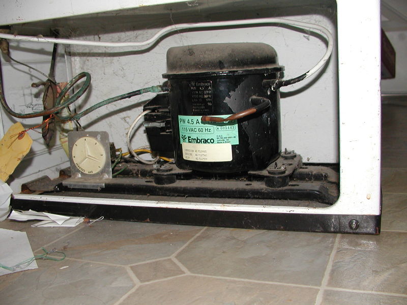

POLAND_SPUD wrote: ...now speaking of fridge... have I told you about fridge compressors ?? they are great high pressure pumps and...... :wink:
@ BTB lol show us pics of it...
Since you asked.. :D
Why do you want photos of my fridge?
Fridge compressor..  LOL..
It's a kind of weird fetish...
...don't ask :wink:

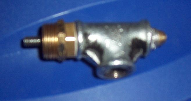

Haven't had time.
Í hope I'll have time today, if not, I'll post parts- and assembled pic tomorrow..
Netherlands
Posts: 3497
Hope this helps..
Just a 1/4" galvanised T..
One end holds a 1/4" fitting, other side has a threaded tube screwed inwards.This too could be an ordinary fitting.
(The inside diameter of the right side must be slightly larger than or possibly equal to the sealing surface on the left.The closer you get the two , the easier it will be to push open at high pressures.
In the case of equal surface areas sealing will all be up to the counter spring..)
Through this runs a threaded rod.On the rod I created a pump-head with two rounded (and sized with improvised lathe )nuts and an O ring in the middle.
The O-ring is slightly larger than the inside of the smooth pipe it slides in, so it seals.( floating-O-ring)
On the other side another O-ring is held in place by 1 nut.This acts like the valve stem in a schrader, or as a poppet valve if you will.
However..it seals from the outside IN.
The slightly larger piston created the force needed to keep the oppposite side shut.
A spring on the inside of the Tee pushes the piston side ( on the right) away from the 1/4" fitting, on the left.
On the left side the 1/4" fitting has a 1/4"-1/2" reducer ring..so , when connected to a barrel, air has enough room to pass the poppet nut.
Parts list:
1 threaded rod
1 Tee ( of any size !)
2 nipples/fittings ( as long as the fit onto the Tee., smooth inside!)
1 reducing ring ( optional, on barrel side)
2 regular nuts, lathed to size
1 capnut, also lathed down, as the actual push button
1 spring
2 O-rings.
And some telfon tape ofcourse.
Air comes in from the bottom.Push the button ( rounded capnut) on the right and air will rush out the left side.<br />It's still easy to push open by hand between 500 and 600 psi..
Internals...minimum parts..just make sure the left inserted pipe or fitting has a smooth inside, so the O-ring seals.<br />You only need a total of 2 O-rings.

Only one more question.
Does it vent ALL the air in the chamber?
Completed projects:
CA1 SMSS Basic Inline
CA3 PDAB Airburst Cannon
Netherlands
Posts: 3497
Nope..it acts the same as a blowgun or hammer valve,
I got 10 shots out of it using the hose volume of my fridgy only!
( at 40 bar, tapping it softly with a hammer)
I edited my previous post..parts list and diagram found above..
