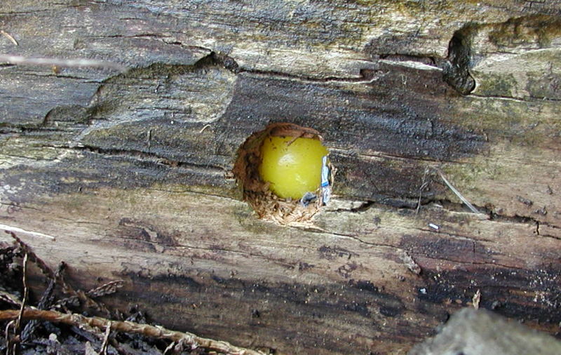

Lemonheads are cheap and pretty tough. They fit 1 inch just fine.Kai wrote:nahhh, any other ball ideas?anything that can go into a 1" or 2" pipe?

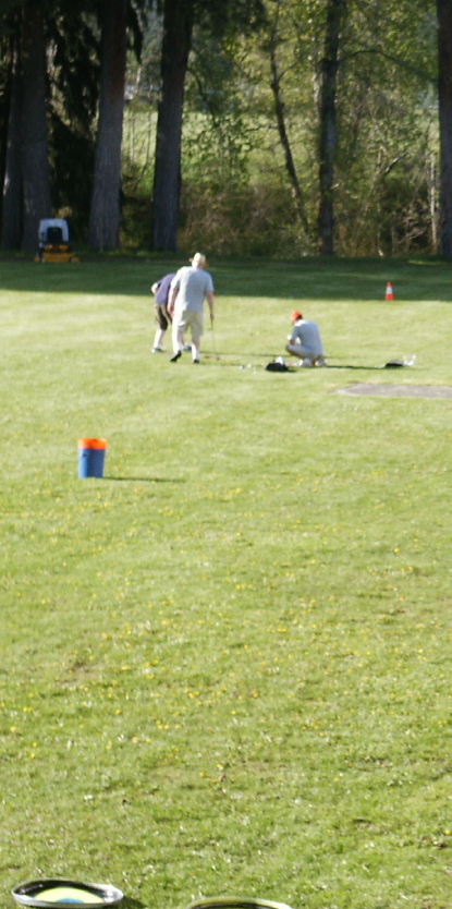

Foam practice golf balls don't go very far. I used my big cannon with the 2 inch barrel with a 1.5 SDR21 sleeve (golf ball sleeve) and gave one a high power shot. It barely made the outfield from home plate. Other than paper towels, I have not had any other item travel less far.JEK3 wrote:For alternate ammo, you can find practice golfballs. They are made of foam, but often have a slightly denser core.
