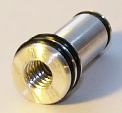

Thanks guys, very helpful! The back rings weren't floating, but I've seen the light, and will change accordingly.
I was using 4 layers of tube that just happened to all sleeve nicely together, but it restricted me with the size of piston/port etc.
So I picked up a 5/8 aluminum rod which is the ID of the valve casing, and I'm just going to drill it to work for the piston rather than trying to make the piston work for what I have. Also it means I can save the piston which took a lot of effort with my limited tools. And will be stronger and better in the end.
The area differential between front and back will also drop, hopefully giving the piston more 'pop' and a faster opening time.
Picked up some new o-rings too, so given I can't add material back to the piston, and I don't want to restrict the port too far below barrel diameter, clearance on both ends of the piston will be .015" total to cylinder. Hopefully that's sufficient.
Now my new question is given the width of the grooves I cut on the back is twice what I now need, could that be a problem with a floating o-ring? I know it will seal fine, but I'm thinking of the transition when high pressure switches from the spring to the chamber, the o-ring will slide back, and presumably lose the seal, which would change my spring pressure shot to shot. What if I doubled the o-rings up, that shouldn't create too much additional friction in a floating set up, and would minimize blow by?
I had thought about drilling the center, but will hold off to see what it looks like with deeper grooves cut, rather have it heavy and not break on the first shot.

Wide grooves is fine. Mine lose seal when moving just like you anticipate. Mine seals up (I can hear it) on the first application of air. Even when using a hand pump, it seals with a good first stroke on all 3 of my cannons.daccel wrote:Thanks guys, very helpful! The back rings weren't floating, but I've seen the light, and will change accordingly.

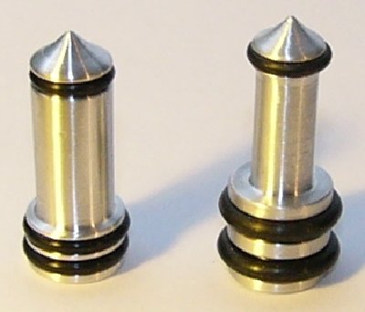

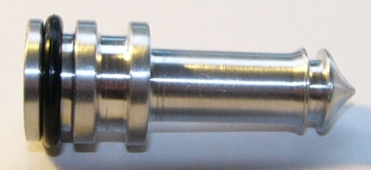

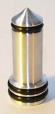

You shouldn't have too much problem unless the space under the rings is excessive. I cut the grooves so the ring will just touch bottom when the top is pressed in flush with the surface of the piston. My space underneath is about the same as the piston clearance.
Take a look at this photo;
The side of the o ring is about even with the top of the groove. The ring needs to seal against the wall of the groove, not ride over the top. This is OK if the ring is squeezed smaller to put it into the cylinder as long as it isn't squished against the bottom. The less you squeeze it the easier it moves. Too small and it may have trouble making a seal.
Now look at the photo below. The o rings barely extend above the surface of the piston.
The 4 inch piston on the previous page has an excellent o ring and groove. Awsome job on that 4 inch 3 inch porting monster. :salute:

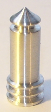

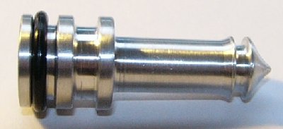

I guess it should be ask twice, cut once. Oh well, I had 34" of stock left
so I decided to start fresh taking into account all your input.
I didn't work exactly to the specs in those links, but they definitely helped to visualize and know what to shoot for.
The back rings have as small a bottom and side clearance as possible while still floating to minimize seal loss on opening. Unfortunately the hole I drilled was off center a bit so I had to shave down the back below ideal clearance to bring it back into center with the front. Hopefully they don't extrude.
Weight is now 4.0 grams, compared to 5.8 before. The hole in the center stops 1/16" short of the front ring.
I tapped the hole and then fixed the tap in the drill press to spin the rod, as the chuck is 3/8" and the rod was 1/2".
I just used a hacksaw and a few different files, because I don't have a grinder to make cutting tools, and then sand paper to finish it. I do have digital calipers, which is more convenient than checking with the oring.
