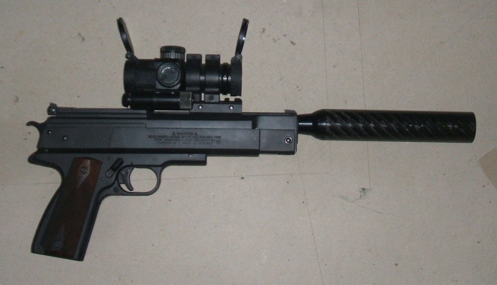

It depends on the pistol, my HW45 (That's Beeman P1 for you 'merican types :D ) will strain the arms after an extended session, and that's only one stroke per shot.

That HW 45 (P1) Looks sweet! I'd put some soft rubber finger gooved grips on it, or hardwood similar though myself.
Or (not my style but) pearl w/silver or nickel plated, w/ polished stainless scope?-might look cool.

THUNDERLORD wrote:That HW 45 (P1) Looks sweet! I'd put some soft rubber finger gooved grips on it, or hardwood similar though myself.
The P1 takes any grips that fit the M1911, I was flirting with the idea of getting Pachymar style rubber grips and having an adapter made to fit the carbon fibre Airstream silencer from my Mk.3 as in the attached mock-up picture, but at the end of the day I prefer the "classic" look and the red dot sight usually stays off.
