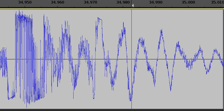

Here is the actual recording of one of my air cannon discharges. Note the waveform at 0.05 seconds after the start.
Mouse Musket Discharge sound.

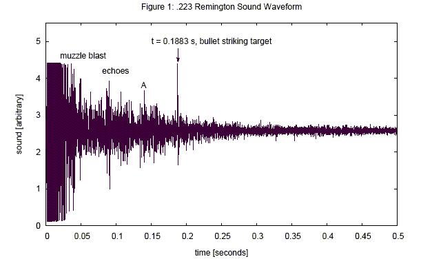

Take a look at the graph here:
http://arxiv.org/ftp/physics/papers/0601/0601102.pdf
It the target hit time is very easy to see.
The noise after the projectile leaves the muzzle is easy to ignore.
BoyntonStu
P.S. Can you suggest a method to take the .pdf graph and convert it to an image for uploading?

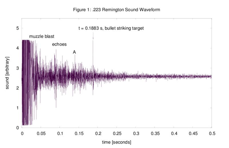

boyntonstu wrote:P.S. Can you suggest a method to take the .pdf graph and convert it to an image for uploading?
Like the attached?
On a PC;
Print screen button (Prt Scrn?), or Alt Print Screen (for just the active window)
Open MS Paint and paste in the screen shot
If you want, copy just the part of interest and paste into a new paint window.
Save the file as a gif.
Looking at the other images in that link reminds why I don't use a mic. :shock: You pretty much have to know what the answer is in order to interpret the soundgrams.

Thanks,
The positive going vertical spike lines of the muzzle and the bullet strike are very similar.
If you know the approximate muzzle velocity you can look at the ballpark region for the strike signal.
The other spikes are not believable.
(One can use a .22 at 1050 fps as a calibration)

On the photo, any OS with screen capture and any good photo editor.
I grabbed it and did it in Ubuntu using the Gimp before reading all the posts. Result is below.
