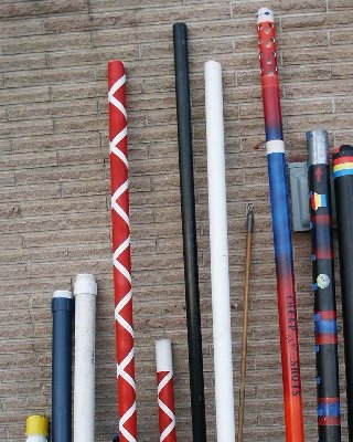

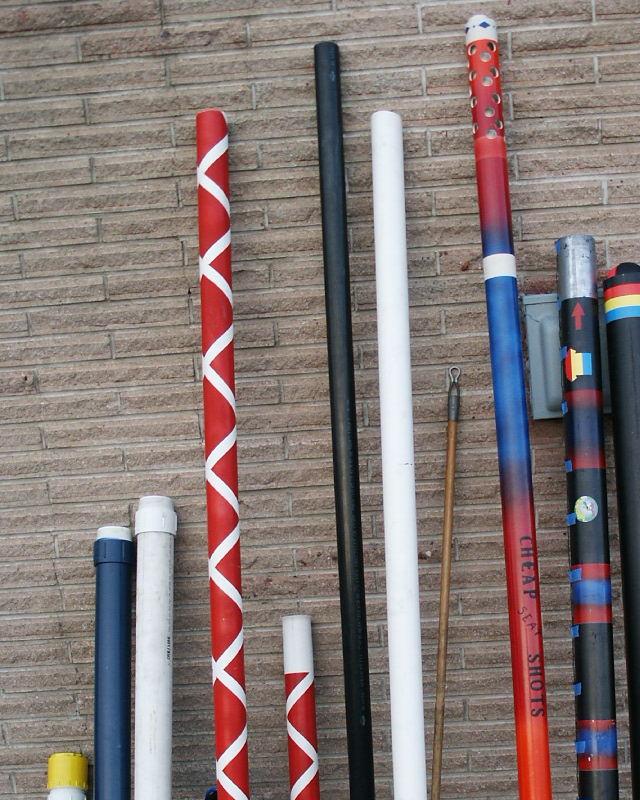

In the t shirt launch coemptition, we did some calculations, and then took a bunch of measurements. Which works better? 2 inch, 2.5, inch 3 inch, 4 inch? 5 feet, 6 feet, 7 feet 8 feet? 30 PSI, 40 PSI, 50 PSI, 60 PSI? We have a stack of graphs from tests and picked a solution that can literally hit any area of the Rose Garden Arena, including the back row of the 300 section.
We guessed the long 2.5 inch barrel would be the best one. I even gave it the best paint job. We were wrong. Without testing, we wouldn't have known.
Is your mix at the peak? Have you tested?
A wide selection of launch tubes were tested.
