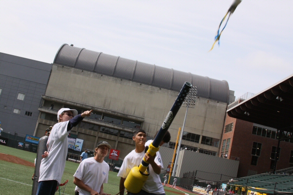

I fully agree that it depends on the projectile. In testing barrels for the t shirt competition, a short fat projectile did better. A longer skinny projectile immediately tumbled sideways and flew straight remaining sideways spinning like a propeller. It's range was much worse than a launch from an unrifled barrel where the projectile tumbled end over end.
Rifling alone is not the cure all to projectile tumbling problems. The Arlington team, in launching shirts at the PGE park got an improvement on range on shirts by adding a tail. They wobbled slightly, but didn't tumble.

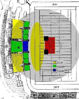

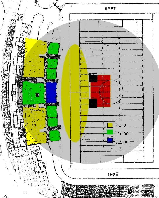

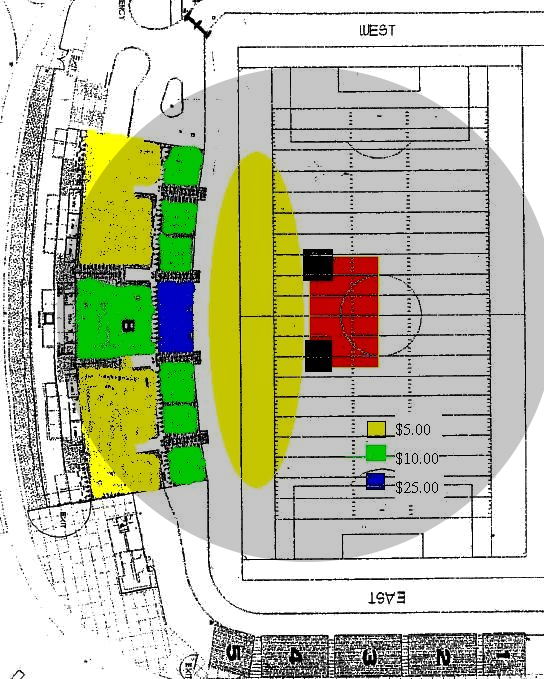

In regards to smaller chamber, loss of range, low noise, high efficiency, etc. our 700 cu in launcher with the 7 foot barrel has a range of almost 400 feet. With the shorter barrel screwed on the miniature model of the launcher with a 54 cu in tank and 1 inch valve instead of a 2 inch valve, we have a solid range of 200 feet.
Using an overly long barrel on the small launcher provides almost silent shots at high pressure.
Arlington team launching a shirt with a tail at PGE Park.  They put one on the roof.

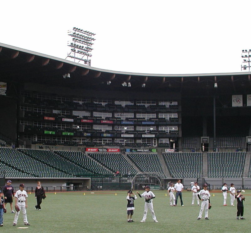

PGE Park.  Above stands, above 4 stories of box seats, above press boxes, onto the roof.
Range of the little tank launcher at the Hillsborro Stadium.  It will be launching shirts at the concert August 8th.
