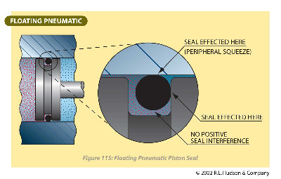

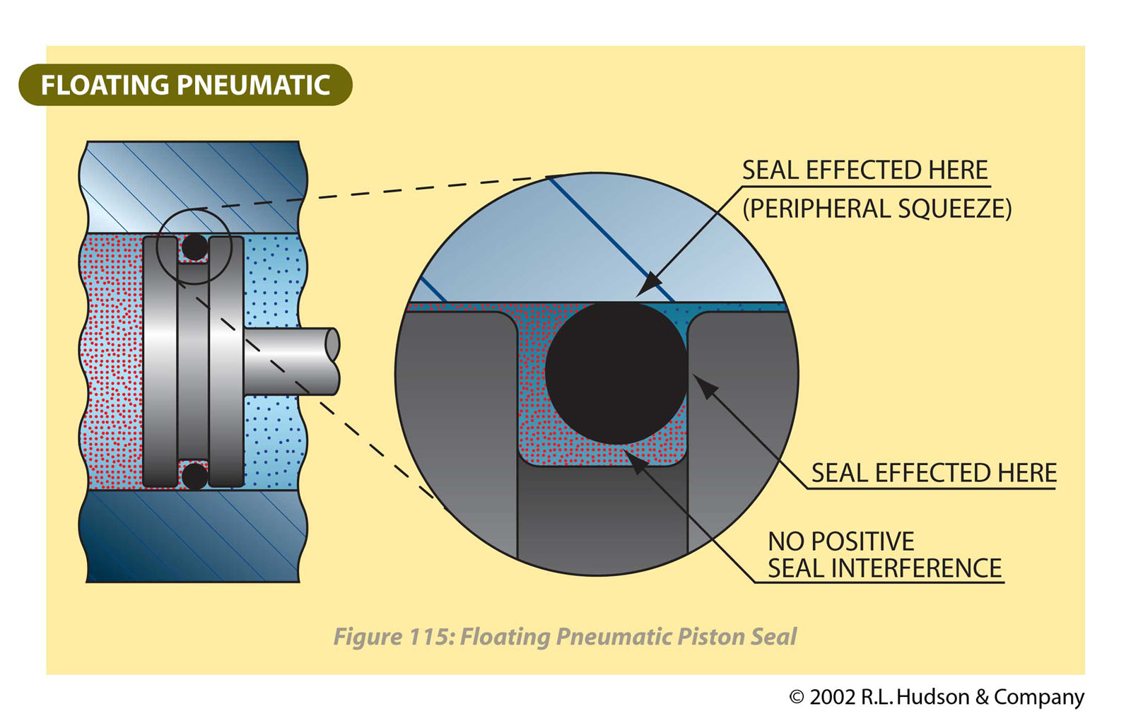

Floating designs offer a number of advantages, including greatly reduced breakout friction and longer seal life. Floating pneumatic piston seals are suited for applications in which the air pressure does not exceed 200 psi (or in hydraulic designs where a small amount of leakage is permissible). Floating O-rings are NOT suitable as rod seals. http://www.rlhudson.com/O-Ring%20Book/d ... namic.html
I found this while researching Technician, i hope it helps.
I can move the bumper to the valve itself instead of the piston, but i am concerned about how to keep it in place, or if a rubber washer or two is even sufficient to cushion the impact.
Very nice.. Thank you. When the piston moves in the QDV and when first filling it does have some leakage. It was accepted as a trade off for low friction.
Their drawing is soo much better than my crude drawing.. Very nice find.
Edit.. Update.. I received permission to use the picture.. Thanks guys..

Floating O rings..<br />Source: RL Hudson O-Ring Design &amp;amp; Materials Guide. Used with permission.
Floating O rings..
Source: RL Hudson O-Ring Design &amp; Materials Guide. Used with permission.

@pvcmaster: good catch
http://www.rlhudson.com/O-Ring Book/Gland Dimensions/table51.html
that's the table I have used for all my piston designs
Thanks for trying to answer my questions btw. I'm not sure how powerful the design will be seeing that the force on a 1/2 inch projectile at 1000 psi is only 196 pounds, while the force on a 2 inch projectile fired at only 100 psi is 314 or so psi.
I know that if you take a chamber and shrink it to 1/10th its original size you will have ten times the pressure with the same amount of air as the original chamber, therefore you should get a 1000% power increase (ten times) but as I said, you still only get 196 pounds on a 1/2 inch projectile, so it seems high pressures wont give that much of an fps advantage at such small barrel diameters...

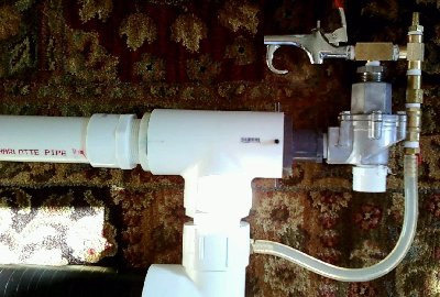

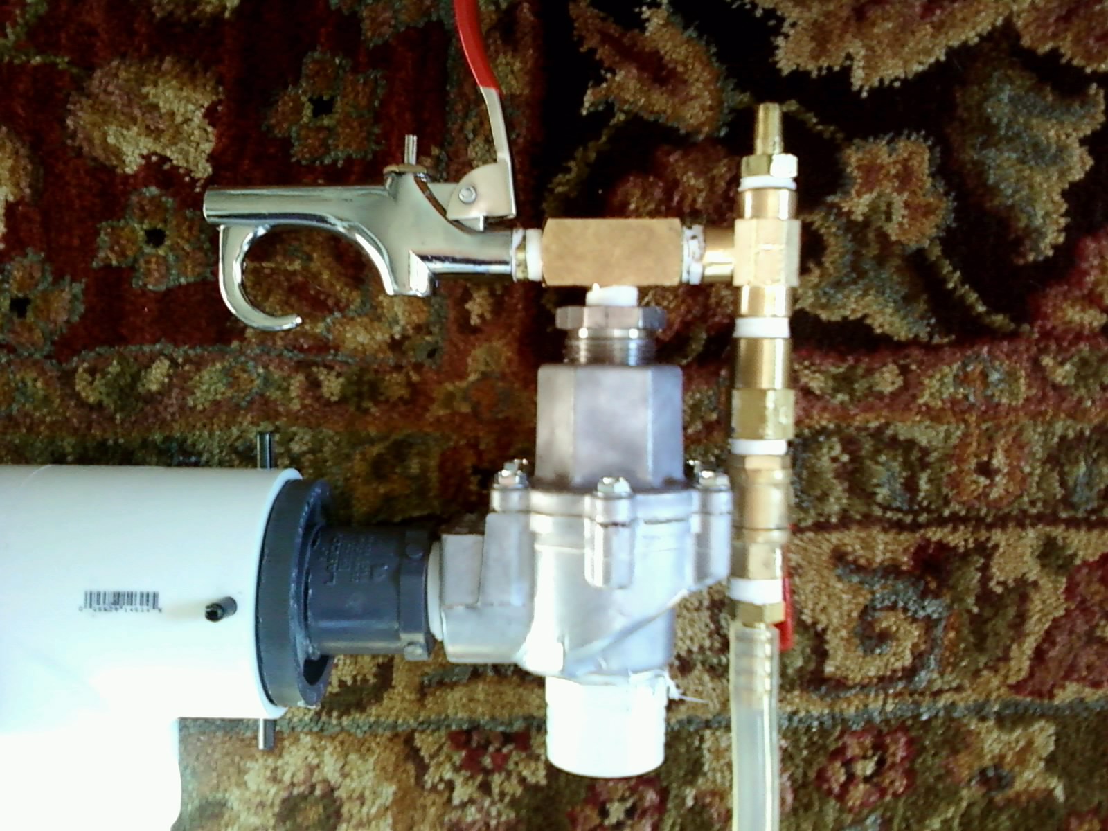

Okay, so it is finally finished! (Sorry to bring back this thread) I took everything i've read here and technicians advice, some math, etc.. to finally design what i think is my best barrel sealer. It is ridiculously loud with that QEV piloting it, and totally lived up to my performance expectations. I'll probably start branching out into some of my own pneumatic designs now that i've got the basics. Thanks for all your help everyone, here are some pictures:

deathbyDWV
Posts: 576
Location: Owasso, OK
Looks good. Got any damage pics or video?
pvcmaster
Posts: 109
Joined: Mon May 07, 2007 6:41 pm
Location: Perkasie, Pennsylvania
not yet, i'll add them soon along with pics of the internals :)

Gun Freak
Lieutenant 5
Lieutenant 5
Posts: 4971
that gun is beast
That QEV alone would make a fearsome valve, let alone as a pilot! Looking forward to the damage :D
Looking good, I hope a video is in our near future. Didn't you have a gulf ball barrel planned for this?
