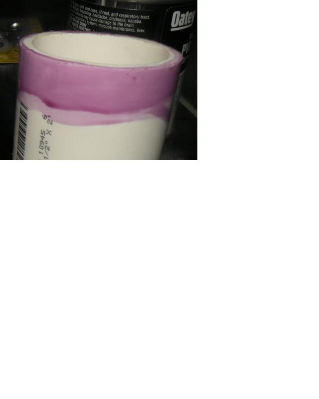

Purple primer is used in the industry in most places as it makes a purple stain and makes a visual inspection of full proper coverage easy.
http://www.oatey.com/Channel/Shared/Pro ... isted.html
- Purple Primer on pipe.
- purple.JPG (19.01 KiB) Viewed 4206 times

Like tech said, that is the whole reason for the primer/cleaner being purple. And, why it is extremely difficult to remove the stain. You basically have to remove the surface layer of the pipe to get rid of the color. The purple color is added specifically to mark that cleaner/primer was used.FORE!!!! wrote: and if it dosnt blow out ,how is the inspector going to know if it was or wasnt done right??
Around here, no purple stain visible (or is visible around only part of the fitting's circumferance) means the building inspector will require the fitting to be replaced. Since replacing a fitting tends to be a PITA (you generally need to replace one fitting with at least two) the local plumbers are quite generous with the purple stuff.

Clear primer is left to rain gutters, downspouts, dryer vents, PVC fencing and other non pressure PVC applications that are exposed to view.FORE!!!! wrote:so where does that leave clear primer?
i await for ur answer in anticipation
so ur saying that u cant use clear primer on pressure pipe installation ,that are in full view of the public??

The inspector will fail it. Neatness counts. In public view, I have been known to mask off the pipe with a wipe of grease to keep runs and dribbles from messing up the look. After assembly the grease is removed and the primer just comes out to the edge of the connection when done properly.FORE!!!! wrote:so ur saying that u cant use clear primer on pressure pipe installation ,that are in full view of the public??
Later I need to grab some pictures of other views of this joint. A very clean job can be done with Purple Primer if measures are taken to prevent runs.
EDIT; Photos of the joint were taken and are posted later in this thread.

You can also use (blue) painters tape to mask with. It comes off clean without leaving any residue and gives a nice clean edge.Technician1002 wrote: The inspector will fail it. Neatness counts. In public view, I have been known to mask off the pipe with a wipe of grease to keep runs and dribbles from messing up the look. After assembly the grease is removed and the primer just comes out to the edge of the connection when done properly.
or u could try using a pre soaked rag,and make sure the primer ends just before the end of the fitting,thats the easiest way

The primer being water thin tends to creep under the edges. I think it also dissolves the tape sticky. Maybe you have used a better brand than I have tried.jimmy101 wrote:You can also use (blue) painters tape to mask with. It comes off clean without leaving any residue and gives a nice clean edge.Technician1002 wrote: The inspector will fail it. Neatness counts. In public view, I have been known to mask off the pipe with a wipe of grease to keep runs and dribbles from messing up the look. After assembly the grease is removed and the primer just comes out to the edge of the connection when done properly.
As an alternative, adding machine tape greased with plumbers grease can be simply wrapped around a pipe while the joint is assembled and secured with a rubber band. Then the joint can be pulled apart and primer applied up to the edge of the greased paper.
I have a wedding this weekend to do sound and videotape, so with preparations for that, It will be sometime next week before I can do a nice set of how to pics.
With care a pre soaked rag is not needed. The daubber works fine if it is blotted a little on a paper towel to reduce the drips.
In australia they dont sell primer with a (so called daubber) it comes with the same type of brush u use with ur blue glue pvc cement (a bristled brush) which is hard to keep neat unless u shake off the excess primer and then that is a waste of primer,u could also hold ur pipe vertically with the primed end on the bottom to stop runs..
