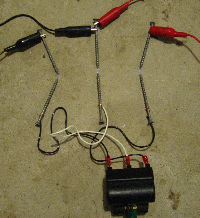

Heres a a pic , there's 3 sparks.[/img]

Three sparks merely means three spark gaps.
Given that you seem to have chained the two screws together with no other connection it means there's no ground wire anywhere.
In other words one of the three leads coming from the box IS ground and the spark is merely the spark from the other two jumping its second gap.

Right. The current travels from the two side terminals to the center one. But it makes 3 sparks as it is designed to. Also i've noticed that if I use only one side to the center, the spark doesn't seem to have that nice blue color that they have when all 3 are going.

Hotwired wrote:Three sparks merely means three spark gaps.
In actuality, the 3 nails connected together with the red and black jumpers would be the ground. If using only two burners, the center arc would be eliminated by grounding the center terminal by shorting across the center arc to the jumpers common. This can be used with 2 or 3 arcs.

Grounding the ground?
If the three screws were not permitted to arc to the central terminal both the other sparks would fail.
Why would you call the spark strip itself the ground.

I'm with wngovr now. When using this with a grill, the two + electrodes jump over to the burners and into the frame of the BBQ. The third negative electrode jumps spark from the third burner back to the ignitor.
In the picture, the upper nails represent the burners of the grill, and the lower nails represent the electrodes.
