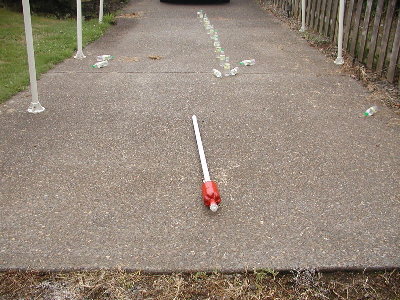

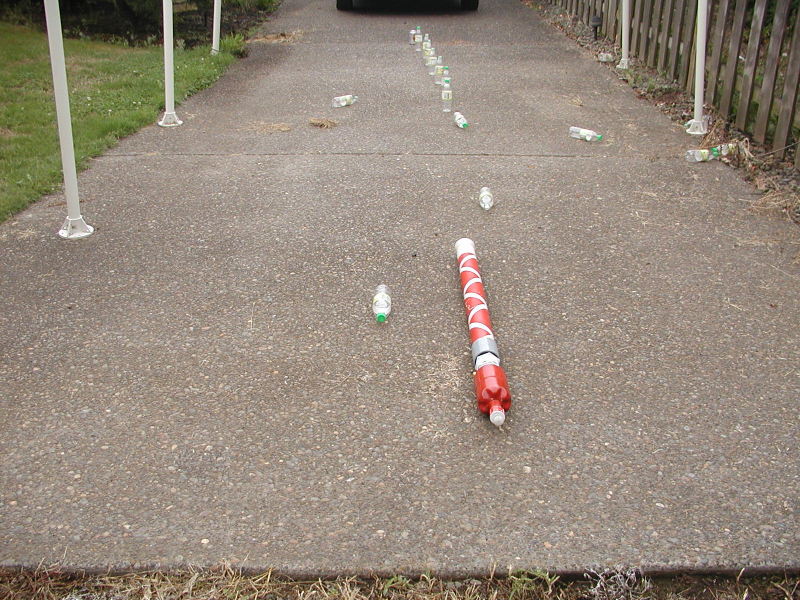

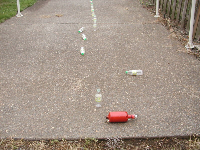

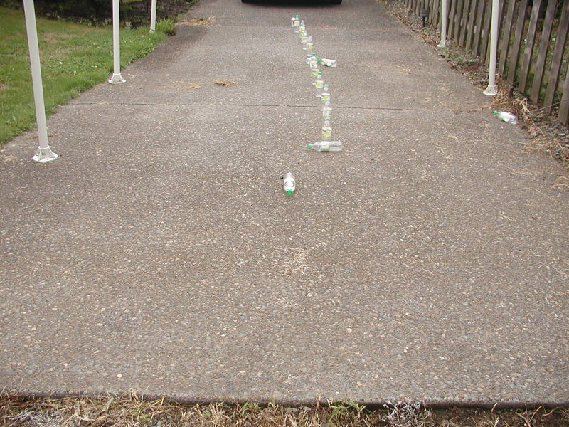

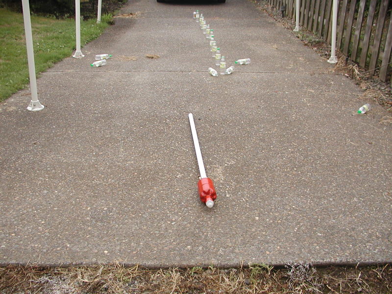

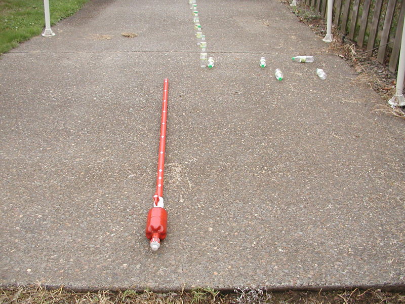

Edit; Testing was in order. I took a few minutes this morning to run a quick test. Results posted below. I had just returned cans, so I didn't have enough, but I did have a collection of bottles. :D
All shots were taken with the end of the barrel at the edge of the cement.
The barrel that shouldn't have had high velocity.  It did a very nice job.  Maybe this thing will work well with a nozzle cone.   Still didn't reach 20 feet. Barrel ID is 2.7 inches.

Test barrel 3.  A short barrel that didn't do too bad. This is a 1 inch barrel.
Barrel test 2.  Sorry I forgot to put it in the picture.  This one blasted a bottle into the air and over several bottles and knocked one over in the back.  This barrel is my red 1-1/4 inch marshmallow barrel.
Barrel test 1  long 1 inch barrel I use to shoot gumballs and jawbreakers.
Bare tank blast zone.  I held the tank a little high and missed the closest bottle.  Valve outlet is 1 inch.
