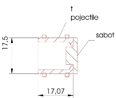

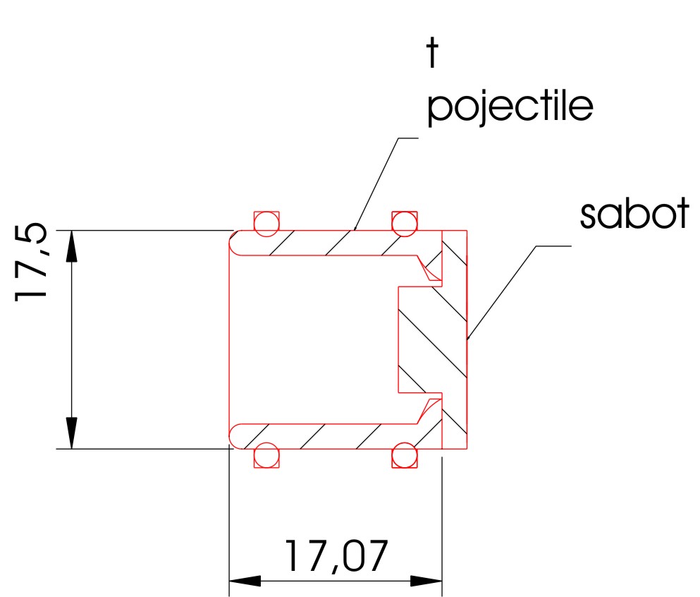

While we are on the topic of a projectile center of gravity, I have a design consideration. A hollow projectile driven by a pusher ( plus you can play add infinitum with the projectile dynamic) . Low mass, little drag vs large barrel diameter. Is there any merit to this? I was sure I had found the holy grail half way into a bottle of rum. The next day I wasn't so sure.

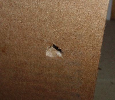

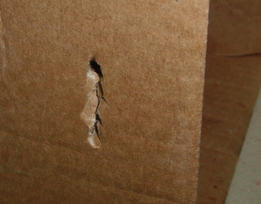

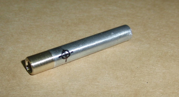

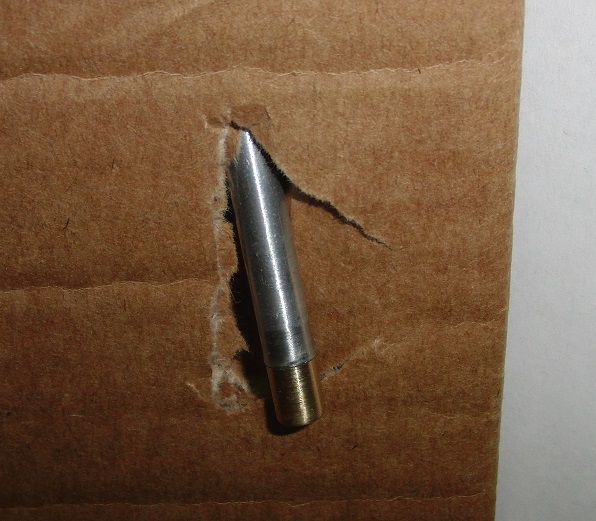

That's the theory but since I believe in science by doing, whipped up a quick test projectile with a heavier brass nose and aluminium tail, hollowed out.
The cross marks the centre of gravity, as a solid projectile it should have flown straight. As you can see though, fired at a cardboard box just 5 metres away, it was clearly tumbling.

Plug the brass end with Delrin nose piece to verify that being hollow is actually the problem!
dewey-1 wrote:Plug the brass end with Delrin nose piece to verify that being hollow is actually the problem!
Right you are, I forgot control group A!
I didn't do it because of previous experience with similar projectiles but yes, for completeness' sake it should be done, eventually when I get home.

Thank for the links to the ammo JSR. I didn't know it existed. As to my proposed idea (the drawing I did) I thought about the projectile needing fins especially because its short with a large diameter. That's why, in the drawing you see material inside at the back of the projectile in my drawing. I thought that perhaps that would create the drag needed to stabilize it. Especially if it was designed to induce spin. Do you think that if the projectile had an airofoil shape it would help stabilize the projectile? That and fins inside the back of the projectile. It would probably have to be the other way round though ( with the inside fins at the front of the projectile to put the cg forward rather than create drag. I don't know. :( My mind keeps showing me an airofoil shape, like a stretched teardrop as a profile shape. I wish I had a 3d printer. What do you think Dewey? Would an airofoil profile help stabilize the profile? Could fins inside the projectile make it spin?

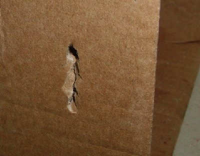

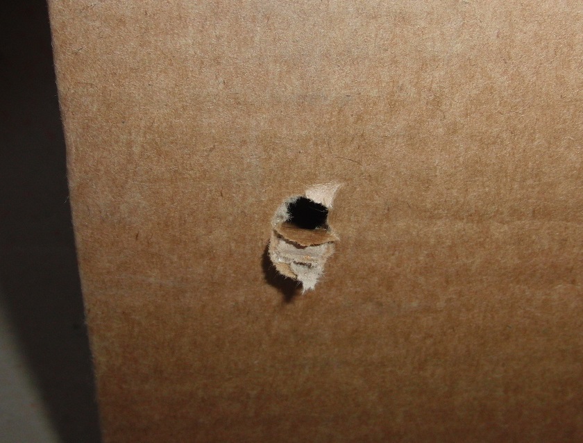

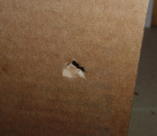

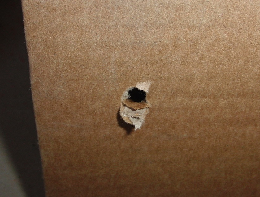

Further to the "cookie cutter" test, as dewey suggested I plugged the nose of the projectile with some foam to give practically identical CG but a closed tube shape and shot it at the same target, two sides of a carboard box. As you can see it was clearly travelling nose first.
